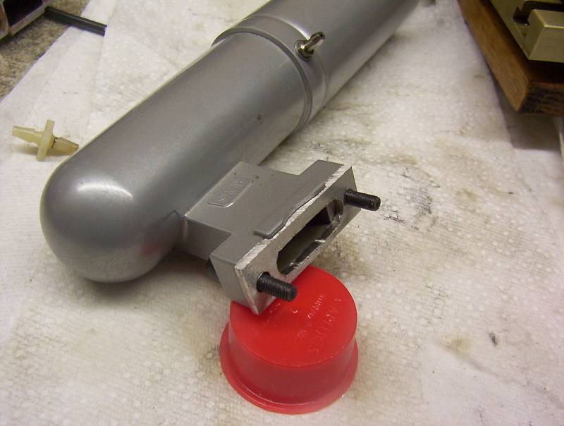

Dar, I made a little adapter for the MVVS 3255 muffler so he would not have to modify the phlanges for the Webra. My adapter is not real purty but works and does not leak. The prop you see is a Graupner 12.5x6 which the .61f turned at 11,300 rpm on Fox 5% nitro/20% Castor.

So, the flange on the MVVS has the 'locator beams' above and below that tend to clash with the cylinder housing, or the exhaust stack itself of the Webra #1024...
This spacer you had fabricated seems to have easily solved the problem.

I just got off Morris Hobbies, where I ordered the MVVS # 3255 it looks like this should work well; The adapter all so looks like it will work well!

Dar, I use that partiicular muffler on my OPS .60, the reliefs are to clear the cooling fins, they clear the cooling fins on the .61f using the adapter.

I recently ordered the MVVS 3255A from Pe. I followed Hobbsy's method of cutting an aluminum plate to adapt the Webra's exhaust port to the opening in the muffler. It's a great fit. Thanks for the help Hobbsy! I will run it this weekend and see how it performs.
