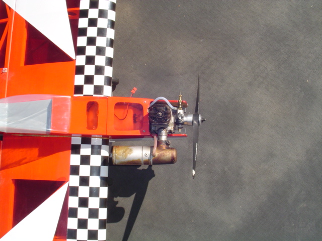

daveopam's Avatar
Posts: 7,810
Received 43 Likes on 38 Posts
From: ELK CITY, OK
Default RE: 90 size engine in 40 size plane
I converted my old Pizzaz to a ST 90. First I cut out the old motor mount system and mounted a round nylon mount to the firewall. This way I could slide the engine way back. Then I mounted two mini servos in the tail and the CG came out just right.
David
