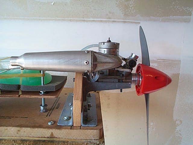

Hello was hopping if someone can tell me if this is right. I bought two engines off a guy that said I was buying two Rossi R40 Aereos for $60 but I didn't fire them up until now. I was reading what the rpm are to show with an APC 10X6 and they say that I should be getting 17000 but when I turned this engine on they are hitting around 25500rpm. The sides don't say what size they are and it has a gray head on it.I'm scared that I will blow the engine with these reading. What I would like to Know is if the guy that sold me these engines knew what he had or am I doing something wrong. Second I bought these engines for a trainer because I got two for $60, I didn't buy the os46FX did I make a mistake.

Tested the tech on my friends engines, and on the MDS 40 it reads 12000 and his 0s 40 la reads 12500. The tech it set for 2 blade, I'm using a 2 blade. Then put back the Rossies and it said the same thing 25000 to 25500RPM's steady (screaming very loud) This engine is not much bigger then a 40 size.

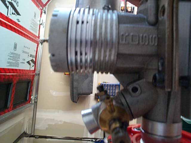

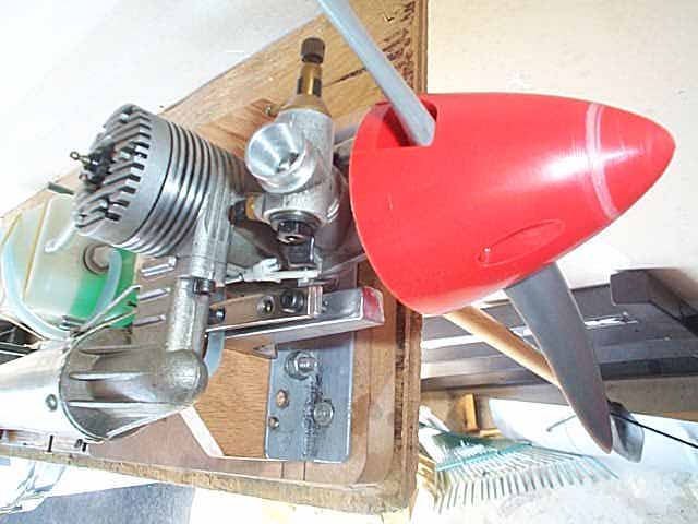

I tested the engines today with another tech and got the same reading. My buddy said that this is not a R40 Aereos it is an older engine and it might be a Q500. hes never saw anything like that so he offered to buy the other engine off me for $60. I told him I will let him know I first have to talk to you guys about how much. here are some pictures of the engine so maybe you can tell me what they are.

Looks just like any Rossi .40, and it is not old..at least the carb is the new style.
A pic from the Rossi website
Yours has the older style muffler.
I find it amazing that you can get 25.500 out of a front intake, side exhaust engine with such a small bore carb and a stock un-tuned muffler. Every other Rossi .40 on the planet would have to run with nothing but the spinner to get those numbers..and it would have to be a smaller spinner than the one you are running at that.
Which brings on an even more incredible feat. That you are able to run a plastic spinner at 25,500 and not grenade it. Of course I would like to point out that your plastic spinner is more than likely the only plastic spinner in history that has not flown apart at 25,500, but then you probably knew that.
An interesting side note..your tip speed is about 758 mph.
At STP this is roughly .99 Mach.

I also see in your pics that you have it in the garage..under lights.

Chuck - I hope you didn't feel like we were attacking your statements. I for one was dumbfounded the first time I had tach'ed my engine.
I ran it for 8 years before I ever bought a tach. I was wondering why I couldn't get as much power from my new Magnum. When the Magnum tach'ed at 15,500, I turned to the ASP for comparison... Imagine my surprise. I then checked my friend's, and it read 15,200. He doesn't own a tach, so I waited till I could borrow one to validate my #'s. 4 different days, 2 different tachs, 2 different props (both MA 10X6), always peaked around 22,000.
I can understand the hesitance to believe my readings, but my own disbelief has caused me to verify them a few times. I don't mention the RPM's often because it always results in discussions like this where the naysayers say it can't be. I just live with the fact that it runs great, and "don't look a gift horse in the mouth".
If you're ever in Winnipeg, let me know and I'll let you measure it with your own tach.
BTW - any physicist will tell you there is no such thing as centrifugal force. What you're refering to is inertia applied to an object kept on an angular path by centrepital force.

Strato, Irrespective of centrifugal force being non existent in the theoretical sense, you cannot deny the fact that having a monster spinner on your engine does not get affected by it's on inertia, and in my expericence with plastic spinners some form of deformation.
Sorry, but I agree with chuck on this one, I've been playing with engines a LONG time, and even our pylon motors would be hard pressed to clock over 21.
Here's a tip, record it's sound and by using a pitch tach, see what you get. You might be suprised!

I don't know where to borrow a pitch tach from, but I'm not about to go out and buy one. I can tell you that my ear tells me it has a noticably higher pitch than anyone else at the field. Next time I run it, I'll take a tape recorder with me, and post it here.
P.S. My spinner is much smaller than the one pictured above. 1 1/2 inch I think.
