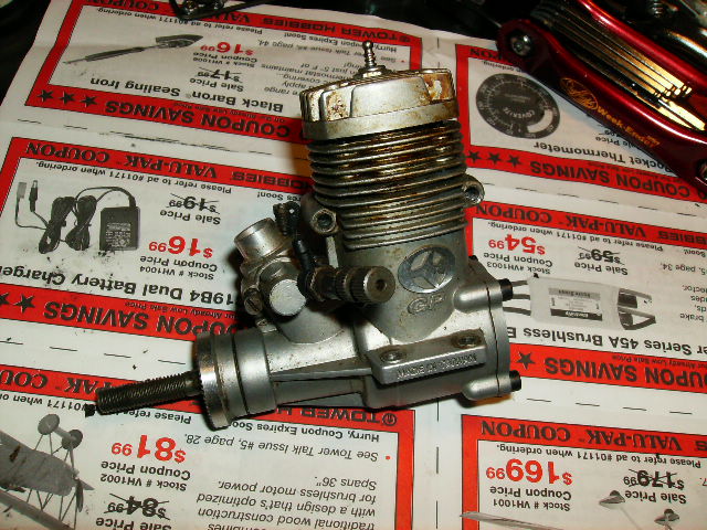

Great news gang. I just picked up a very well broken in GP42. It is dirty and covered in castor but the only problem I see is the wrist pin is stuck probably from all the dried castor (bless them)
So I shall establish a baseline , optimize the stock configuration with proper fuel plug and compression changes then start in on some minor porting. I just live for this kinda stuff.

The carb barrel/venturi opening of the TT .42 GP is only .220" IIRC and I think if you were to open that up a little...say to .250" perhaps, that would be a good start. (that and a better muffler, maybe the GMS .40 muffler would work? )
The carb is a bolt on type, and that makes it virtually impossable to swap carbs...unless I suppose you wanted to machine some sort of adapter.
When I modify a sleeve, all I typically do is to radius the lower lip of the port openings on the outside of the sleeve...and I have seen 200 to 500 r.p.m. increase depending on the engine. It also depends on how efficient or (relatively ) crude the engine is in the first place.
I got 400 r.p.m. more from my O.S. .61FX for example with the sleeve mods and a little polishing of the crank.
the sleeve. Cylinder liner? Yes I have to agree. I try not to touch the liner if I can get away with it, but when I see a sharp edge I just have to knock it down. To maintain the throttle response it is advisable to keep the carb as small as possible. I have installed smaller carbs on some of my engines and found the throttle response improved greatly. I do however recomend polishing the "stack" and radiusing the intake to the carb somewhat. [8D]
The throttle response will definitely be better with a smaller venturi...
I think though that a .030" increase won't hurt that (not much anyway? ) and the top end will be stronger. (.220 is pretty small )
You could however "bell mouth" the openings in the carb barrel...and leave the central portion the stock dia. That will also give you a true "Venturi" instead of a straight through barrel opening, and the fuel draw might actually be improved, as well as the top end.
I agree Jeff...the area above and below the carb barrel can be re-worked and you can see an improvment.
IMO, with airplane engines, the top r.p.m. is generally not high enough to warrant/need extensive sleeve mods like we see being done to some of the car sleeves and cranks. Just a mild clean-up will suffice.
As mentioned previously...when it comes to material removal, it's better to go at it conservatively...at least at first.

All cleaned up and ready to go. Just gave it a run. Sig FAI fuel, Merlin red plug, APC 10X4 prop, OS 40 unbaffled muffler. Turned 13,600 without a hitch.
I didn't do anything to the engine but clean it and put it back together, still has the head shim installed. Even after 2 tanks of fuel and too hot to touch is has a lot of pop to it.
Any suggestions from the crowd?
