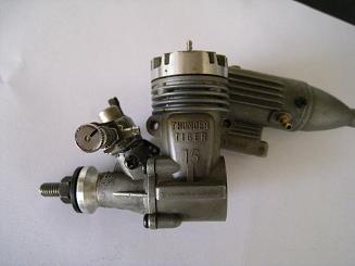

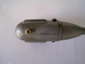

Hello dear members.
I’ve just bought this fine old engine for my Graupner Fokker D.VIII.
Questions:
The first picture shows a metal thing which is located in the muffler (picture 2). It has an approx. 2 mm hole. What does it do, and what do I connect it to?
How old is it?
Thanks.

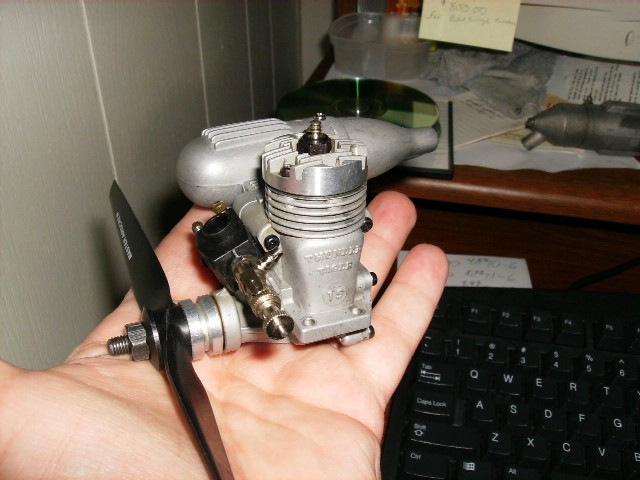

Before the days of mufflers people primed their engines through the exhaust port. This practice lingered on after engines came with factory mufflers, so the manufacturers provided a priming tube in the muffler for this purpose.
I have one, too.

Dave your engine don't look nuttin like his engin.

The engine to Lille-Bror are more like Enya 15 engine.

yes, but the muffler is the exact same part. ...and that's what the thread is about.[>:]

As some astute folks pointed out earlier, yours resembles an Enya and mine resembles an OS Max. The Taiwanese (and the Chinese) were basically trying to clone Japanese engines, at least in outward appearance, if not in metallurgy. I 'd like to know which one came first and if the change to copy a different engine was due to any sort of legal pressure.

G'day all. I first saw Thunder Tiger 15 engines back in the mid 1970s. I think they were made in Taiwan. They looked very much like Enya engines at that time. They were selling for less than AU$20 if I remember correctly. An OS or Enya 15 would have been about AU$30 at the time. There were also Fuji engines that looked similar but I think they were made in Japan. At the time I was too busy playing with Super Tigre G20 15 diesels and G15 glow engines. These cost about AU$40 to 45 at the time. The very elegant Super Tigre G15 RVD was about $90. They could be made to go really hard but tended to break crank pins. The Thunder Tigers of the time were very much entry level engines. They have improved out of sight in more recent times.
