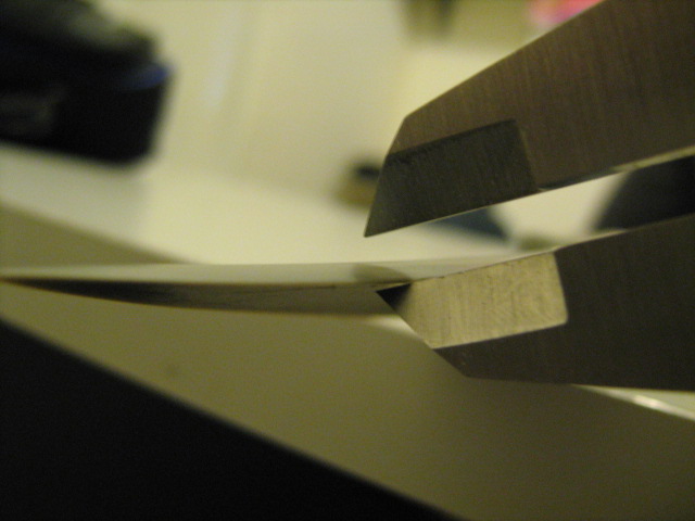

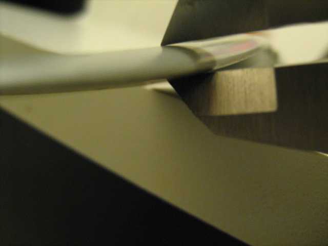

The higer flexibility that has MA (black props ) compared with APC mean something related with performance ???
I have seen that a 11x8 MA produce "similar" load to the engine that a 11x7 APC , I think the big flexibility of the MA may twist the blades remaining pitch . But what if the material were changed to the same material wich has APC props ??? I suppose that fact will load more the engine = less RPM rigth ???
Probably another factor that could modify the performance is the total mass produced by the weight of each prop .
I have reduced the airfoil of APC props and making it light and this mod. make fly faster the airplanes , what is this efficiency or efficient ??? [&:]
