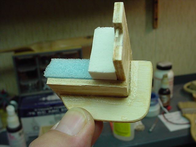

My Feedback: (21)
Shoot, almost all planes have a center of the engine
mount hole cut in them for the tank to stick through.
I'm kinda' a vibration nut myself....and always make a
foam rubber donut....for the front of the tank.
Here's a rear tank mount I made for the Arresti....
I know.....a little overdone, I guess....but it's fun
