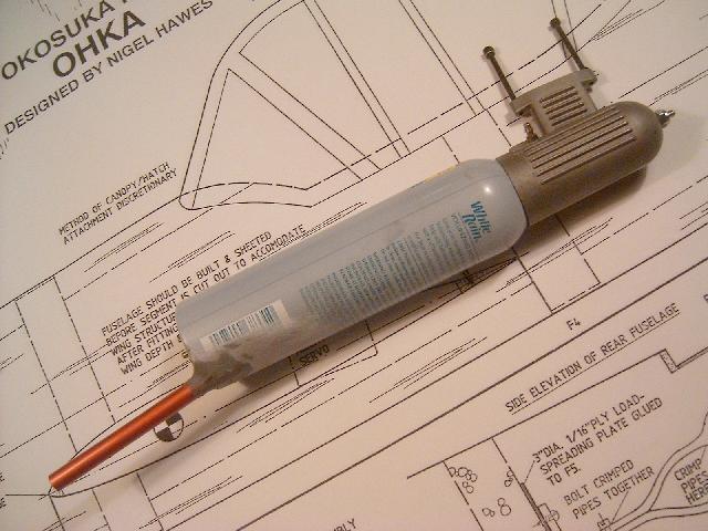

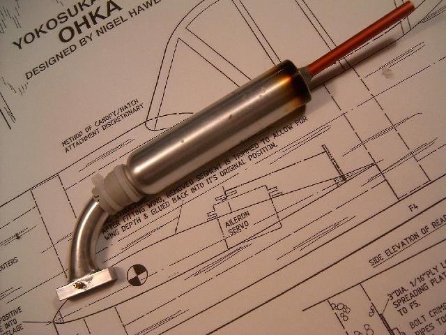

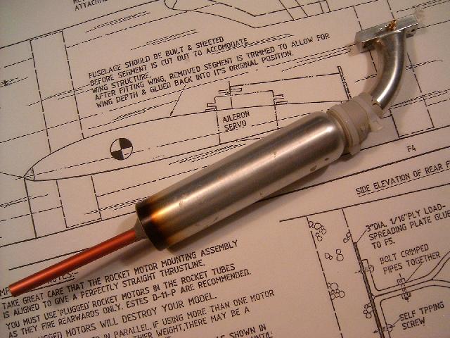

Below are some pictures of the .15 muffler.
I am going to make one for my Evolution .46 and see if it will wake up my Raptor f-22.

Well for what it is worth, the pics show the pipe I made for .15 and .25 engines.
I did try the muffler on a .46 macs header and on my evolution .46 engine. As posted, the stinger was only .25" x 4". I lost RPM.

Made up 2 versions of my mousse can muffler for my Evolution .46.
Did some RPM measurements and came up with this comparision.
Ver #1:
macs header, 4oz mouse can, 4" 5/16 stinger
Stock setup 12,500 RPM w/10 x 6 APC prop.
Ver #1, Max PRM 13,100, w/10 x 6 APC prop.
Ver #2:
Stock muffler header, White rain Moouse can , 4", 5/16 stinger,
Stock setup, 12,5000 RPM, 10 x 6 APC prop.
Ver#2, Max RPM 14,200, 10 x 6 APC prop.
The results show the winner.
I did not try to TUNE the stinger, maybe I could tweak a few more RPM or Loose some. I was happy with the results.
Version #2 is a .46 stock header, the Mousse can fitted to the end of it, NO baffle inside. A 6/32 threaded rod to hold it all together and a 5/16 x 4" stinger on the bottom.
I tried this version without the stinger and got very poor results, no back pressure in the can and it was just noisey.
Larry

The only Macs header I had for a .40 size engine was 5 inches long. I had about 2 inches into the can.
JB weld epoxy holds the stinger in place. I tried using Aluminum solder but my first try melted the stinger. So I just epoxy'd it in.
I also didn't mention that the larger White rain muffler only weighs 1 oz more than the stock muffler.
