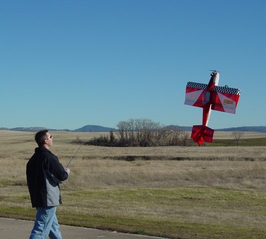

Default 11.5 x 4 APC
I fly my H9 Pizazz/ gms .47 with a 11.5 x4.
Hovers all day long...and climbs out with comfortable authority.
I didn't quite get the RPM's I like out of the 12x4...even though it pulls nice....throttle response and top end suffered a bit.
Hope that helps!
