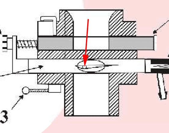

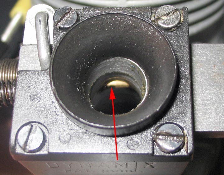

I'm assuming that this drawing from the Webra manual is stating that the hole in the spraybar should be off center with the venturi fully open. Look at the red arrow I added to the illustration. The manual depicts the hole over to the side away from the NV. This is how I adjusted my carb. I guess I'll find out if it's correct.

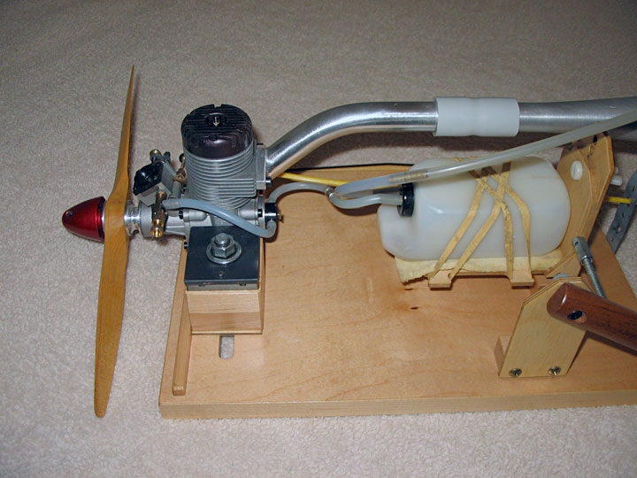

Very nice test stand. With the spray bar fuel discharge hole in the center of the venturi it would seem that you might have better mixture/atomization of fuel and air?
Bill
Bill
Thanks Bill. I agree that logic suggests the spraybar hole be centered. But, there must be a deliberate reason why that illustration was draw the way it was. The draftsman/illustrator certainly must have made a conscious decision to locate the hole off center in the drawing. I can't imagine it was simply a haphazard act (having done some technical illustrations myself).
Test running the engine will be the only way to know for certain, unless someone else here who has experience with Dynamix carbs chimes in.
David
David
You will find the proper location through trial and error. The location of the hole itself is not important, since the entire spray bar tube slides along with the air valve slide...it's the relationship between the two that's important.
The "cats eye" tapers to nothing, or almost nothing as the slides slide together, out towards idle..and that leans out the mixture.
Just run that sucker and you'll figure it out

Dave, that spraybar you have to be careful you have it pointed down into the bore if anything. If you set it pointing upward at all it will blow back into the fuel line. The V groove location is covered well enough by the thumbscrew on the throttle plate so that can be adjusted out no problem.
The rotation angle of the mixture tube I figure has a great effect on how well the low and high speed mixtures pan out on it, because this angle has everything to do with how the spray pattern develops.
Looking at the Webra sketch, and my own line of thinking, the top of the V groove should start to form a hood over the groove looking straight down at it to help form a vacuum in the groove as the air passes.
It might be worth the time to rig up a simple flow bench using a piece of clear tube to the carb and then that to a shop vac, and flow water through the carb and try different angles to see what pulls the most water up a loop of tubing.

Hobbsy, I think I see your point, except that the spraybar moves along with the slider as one assembly; they are attached to each other.

no, lean it out.
If I recall, the low mixture adjustment actually moves the spraybar position.
My old CMB .60 had the same arrangement.
Oh...!

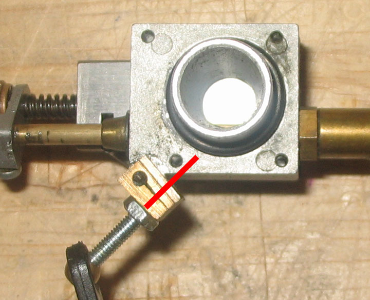

One more thought..... after looking at your photos....
The only thing that keeps the slide in the carb body is the throttle lever. Make sure your throttle linkage does not permit the wire to leave the slot. If it is possible for the wire to leave the slot (especially under vibration with the throttle pushrod shaking around a bit) the wire WILL leave the slot, and the slide will fall out of the carb body (and of course depart the airplane at the worst possible time into thick jungle/grass). In a best case, the slide does not fall out, but you loose throttle control.
One way some of us avoided that ...... drill and tap the slide end toward the high speed needle side. I had a machinest friend do it, and it was a #1 screw. Small screw, washer,locktite installed after the slide is in the carb body. Creates a stop flush on that side of the carb at full travel position. Prevents it from falling out.
it was a good fix. Webra adopted it. The current version dynamix comes like this from the factory.
(reference ..... http://www.webra-austria.at/motor.ph...BURETTOR&lang= )

Yes, Bob, I have already discovered that problem with the older slides! I also saw that current photo on the Webra site and the stop screw fix.
Since I have no way of drilling and tapping the slider I thought up another fix. I was going to try and find a longer threaded rod and have one end extend far enough to actually hit the crankcase where the carb mounts. The length of the threaded rod could be adjusted to make the wire stop at the desired spot. Maybe my photo will make my idea clear.
David
David
I've purchased the Webra throttle arms before. There are two different lengths offered, or have been, just so your aware.
The thread size for it is an M2.5 and threaded rod for it is at [link=http://www.smallparts.com/s?ie=UTF8&refinementHistory=subjectbin%2Cmaterial_ browse%2Csize_name%2Cmeasurement_system%2Cthread_s tyle%2Cbrandtextbin%2Cenc-merchantbin%2Cavailability_class%2Citem_length_str ing%2Cavailability%2Creview-rating%2Cdate%2Cis_prime&pf_rd_r=06365SNDY05MV77K2 GYN&pf_rd_p=417978501&searchNodeID=16410711&pf_rd_ i=16410711&searchRank=salesrank&field_size_name=M2 .5&pf_rd_s=center-2&searchSize=25&pf_rd_m=AIUBT5HP6PMAF&pf_rd_t=101& searchBinNameList=subjectbin%2Cmaterial_browse%2Cs ize_name%2Cmeasurement_system%2Cthread_style%2Cbra ndtextbin%2Cenc-merchantbin%2Cavailability_class%2Citem_length_str ing%2Cavailability%2Creview-rating%2Cdate%2Cis_prime]SmallParts.com[/link] and can also be used for replacing the throttle plate adjustment.
