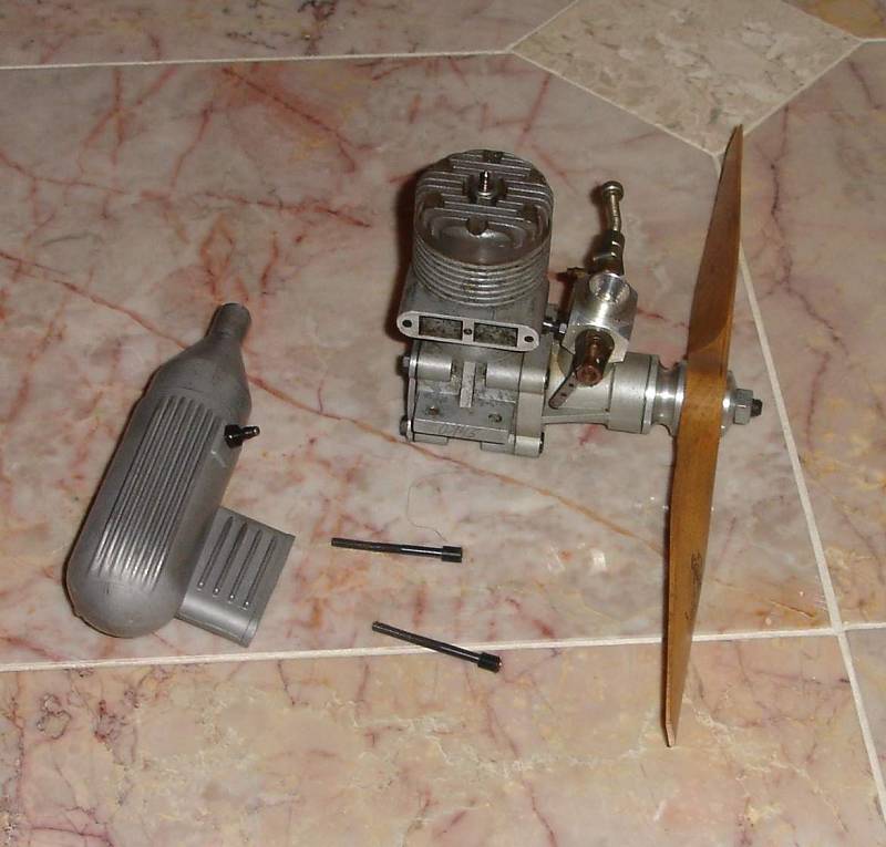

[]. Hi. Do any of you know why the old Webra 61 Black Head had a very nice bolt on muffler and the engine had provision for it, and the more modern Webra 61F Speed has no provision whatsoever, so you have to use an after market strap-on?

Good question. My .61BH and Speed 1.20 have bolt holes but not my Speed .61 and Speed .91. I did drill bolt holes for my Speed .61 and used an Enya .60 muffler.

The current version of the Speed .61 has a bolt on muffler...the one you have there must be a "middle" version...my guess would be 80's to early 90's?

I've drilled/tapped a few of them to the spacing of the OS 60FSR and used the OS mufflers/headers.

Pure economics. With no drilled and tapped holes and no supplied muffler. They could sell the engine cheaper.

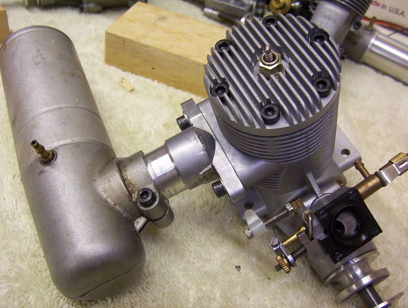

The latest .61Fs are drilled and tapped, I too have drilled and tapped a couple of older .91s, I tap them for a Fox .74 exhuast for which there are several other mufflers that will fit. Here are a couple of examples.
