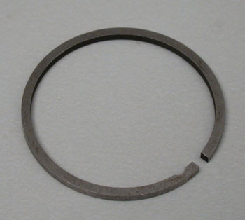

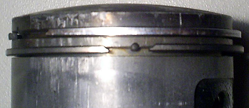

Wrong, Charley!
The pin does not protrude fully through the ring...
The ring ends can touch each other, over, under, or outside the ring...
The first photo is from Wiki, shows a pin protruding into the upper part of the middle ring.
The other two from Tower show the OS ring, which closes over (outside) the pin and the Super Tigre ring, which has the pin 'cavity' completely outside the ring-gap...
As to the actual gap, Bill; Jim is right and it should be about 4 thousands per inch of piston diameter.
With the Enya .46 having a bore of under 1", the ring you have should have a gap of about .004".
So yes, it does seem excessive.
Talk with Frank Bowman. He's very helpful; even on the phone.
