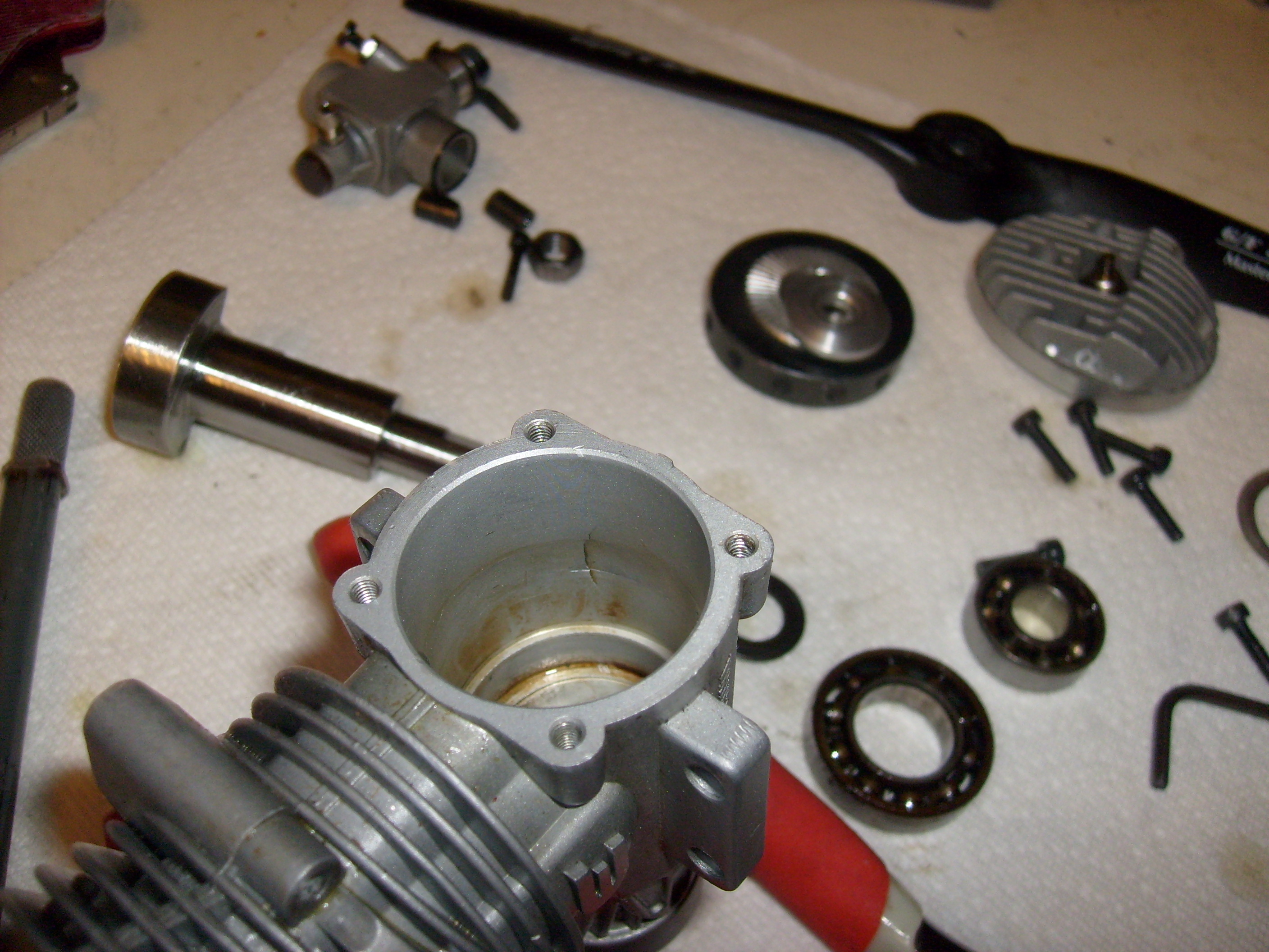

Has anyone attempted to fix when the rod cracked the case?

The best solution is to use a new crankcase.
In your case it appears to be in a non structurally critical area. You might be able to get away with using some JB Weld in the area

I would get my Dremel rotary tool and "V-grind" a notch in the crack being very careful to not break into the inner crankcase and have it heliarc welded by someone who has his/her stuff together. If you are real anal have it mgnafluxed by a certified aircraft technichian and if the crack is contiguous through to the mating surfaces - dicard it.

I maybe seeing things but I super enlarged the inside of the case and there is a crack that goes up to the cover surface. I would get a new case. Just my 2-cents worth. Good Luck if you weld it.

The only thing that would make me try to repair that CC is if there's no replacement available.

I vote for JBweld as a cheap fix. All it needs is a seal to prevent air leakage. Any thing else quickly approaches the replacement value of the engine. I would scrounge around swaps and online classifieds and such to find a dead engine with a good case. Often cheaper than new parts and you might get other good spares. This can of course take time.

Which Evolution is it? Because the .46 case is about the least expensive one I've ever seen:
http://www.horizonhobby.com/Products...odID=EVO046101
Try pricing a new OS case.
But... this is the part of the photo that bothers me the most.[X(]

There's also the question of the con rod and piston. What shape are they in? If they're shot it may not be economical to repair.

If this were my engine, I'd be more worried about the con-rod than the case. The only repair you need here is to be airtight.

Can't we just assume the rod is garbage? I mean he said it broke the case. That doesn't happen with a good rod. That case is cheap. If you have to order a rod anyway, just get a case.

jib may be right. If you are really brave you could try JB Weld. It should take the temperature and if you clean/roughen-up the surface with lacquer thinner it should adhere well. I just used this stuff recently and it's a nice product.

Cut him some slack fellas. Its apparent the conrod broke off and cracked the case. I would get a new conrod and fix the case with JB weld as structural integrity is not an issue where the crack is.The fix is to prevent any possible leak. Sometimes we get sentimental over our engines and cost conscious at that.No point paying more for the same amount of fun.
