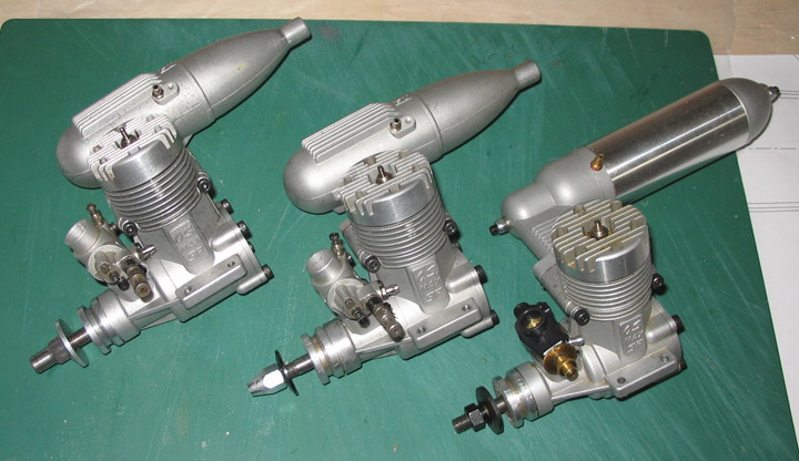

I rebuilt three of them myself over the last year or so. If you need any major parts like a P/L set you'll have to be very patient and watch the auctions and marketplace.
I second RC Bearings; the best prices you'll find.
In the photo two are stock with #7L carbs. The other one has a Perry #1501 and an SK .70 muffler from Kangke which is a perfect fit and a lot cheaper than a #744B
David

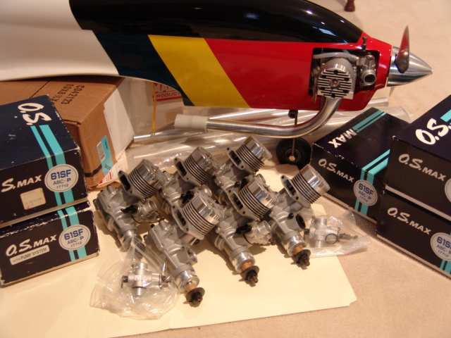

Oh yes! The OS 61SF ABC-P!
