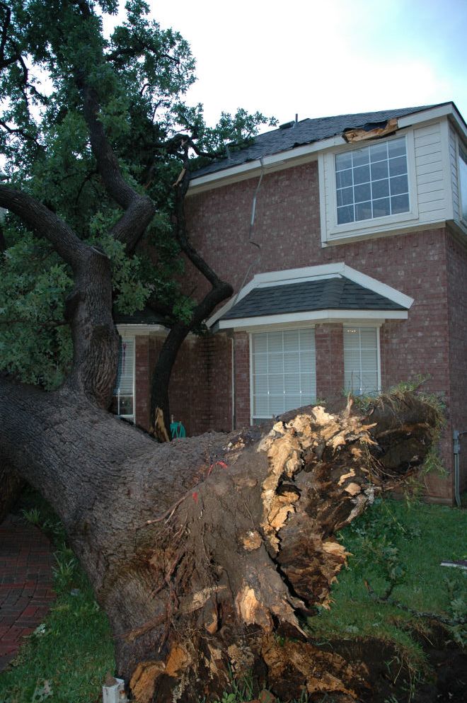

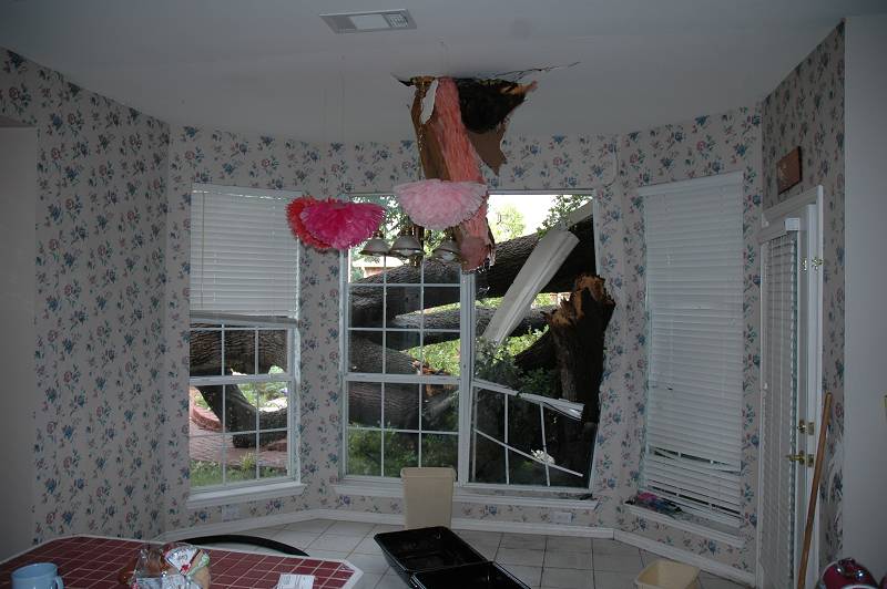

Well, it looks like this project is on hold for a while. Mother nature paid my home a visit last night and pushed a 200 year old oak tree down on top of it. I have lots of skylights now - some big some small. Nobody was hurt but I won't soon forget the sound it made coming down (almost as frightening as a 91 on a pipe I'm guessing). I'm in the Dallas area and lots of trees, signs and fences were blown over in my area with the big storms this morning.
I'm down for now but not out. I'll be back causing trouble in no time!
