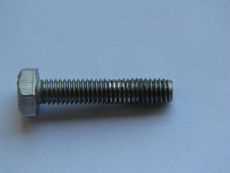

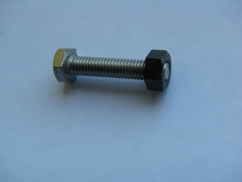

To prove my point, I just went down to the Ace hardware and bought a 6-1 x 25mm metric hex head cap screw. Ipicked a 1/4-28 nut out of the bin and screwed it on to the screw It was a very loose fit at first, and the nut screwed on about10 MM before binding on the thread. At first, I though that may shoot down my theory on what was going on.Then I realized theat "hardaware" nuts and bolts are veryloose fitting. So,Ibought the screw and brought it home to see how the engine nuts fit. The first was of questionable origan and it fit about like the hardware store nut. I then pulled a fresh O.S nut and it screws on the hardware store screw almost exactly three turns before it jams up. 21 flats to be exact. My theory llives. Then I got out my best 1/4-28 die and had a go at the pristine screw. The first 2 1/2 turns went about like the prop nut, no interference and very loose. Then things tightened up and Iwent ahead, with cutting fluid for another 8 turns. The result was what Iexpected.Just before the point where the nut stoped, the tap started over cutting the scrw threads. At about the 12 mm mark, the die was cutting off the top of the threads. Itried the O.S. nut on again and again, it would go the three turns and lock up. At this point, the screw is destroyed, neither a 6mm-1 or a 1/4-28 nut will fit. You could bully the 1/4-28 onto the damaged threads, but as soon as you tried to tighten the nut against a prop, the threads on the nut would roll over and you would most likely have to cut the nut off the shaft.
The Pitch of the two threads are very close. 0.03937" per thread on the 1mm thread pitch, vs 0.03571 thread pitch for a 28tpi thread The pitch diameters are close also, but futher apart, 0.236" for 6mm and 0.025" for 1/4". The loose OD fit is what lets the nut go on for three turns prior to jaming up.
The first photo is the new screw with the O.S. 1/4-28 prop nut. Second photo shows how far that nut will screw onto the 6mm screw. The last is the results of "Chasing" the threads with the wrong size Die.
Added,
It is most likely that the engine in question has a 6-1 metric screw. Also, it is unlikely that the thread is damaged unless he followed some of the advise on this thread.
Don
