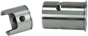

I thought tere was going to be a gas version sold by??? The thing I would lke to know is, does it have needle bearings on the rod & what other imprvments did they make to assure it will last and not overheat? Gas engines run at higher temps tan glow engines. Thanks Capt,n

ORIGINAL: captinjohn
...The thing I would like to know is, does it have needle bearings on the rod & what other improvements did they make, to insure it will last and not overheat?
John,
From the [link=http://www.hobbypeople.net/gallery/214463.asp]Part's description and photo[/link], it seems to be the standard, bronze-bushed item.
This does not wear-out quickly, but requires 5% oil (a needle-bearing rod will do very nicely with 1-2%).
The price, however, suggests it has needle-bearings... The normal, bushed con-rod should cost less than a 1/4, of the $50 they charge for this rod...
The head, however, does seem to have capacity for added cooling; with additional, wide horizontal spans, instead of the short fins.

Yes that rod must be special.....$50. I noticed the rod & related parts was on back order!!! HHHummm. Capt,n

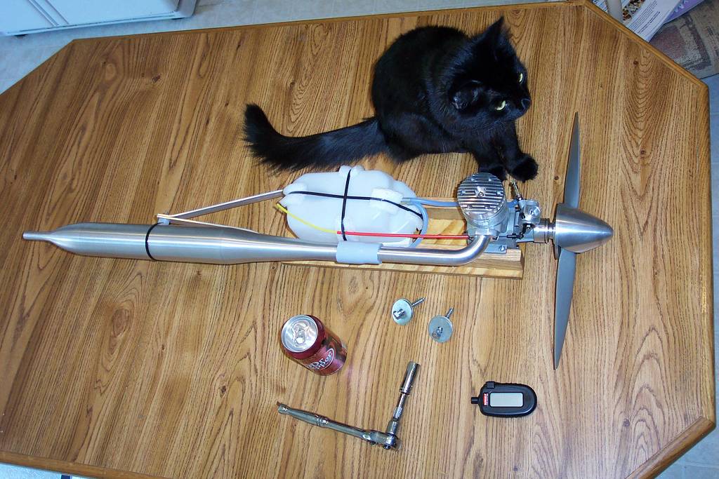

It's the cat's meow.
Picture shows ready for testing with a huge Macs double quiet Pipe.
Mark 2.10 on 5% APC 16x16 yielded 9300rpm.

Old 08-24-2009 | 10:04 AM
Posts: 12,957
From: Hesperia Michigan, MI
Default RE: Moki vs Mark
MR fast....is that right a 16x16 prop??? Wow, I bet the airplane you have that on lands rather fast!!!!!! [X(] Capt,n
Old 08-24-2009 | 08:23 PM
Joined: Jan 2005
Posts: 2,222
From: Mather, CA
The plan was for a giant delta(a scaled up Diamond Dust to 60"), but I cant find the time in this lifetime to get to it, so there it sits. Maybe if I won the lotto and didn't have to work. [sm=teeth_smile.gif]
The engine was in a Sundowner 80" and plane type dedicated (tight fit) Pitts muffler using the same prop. It was turning 7800, new engine + restrictive exhaust. I liked the 17X12 better, don't remember what that turned.
Sold the plane, kept the engine.
Looks like you used 5% nitro in fuel. How much oil per gal and how much castor? Thanks Capt,n
