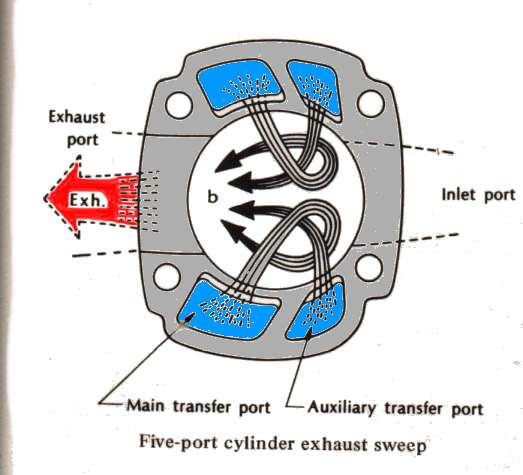

Dar a baffled cross flow engine goes from the intake port to the exhaust port. U shaped from the side. From the top it makes a straight line. When looking at loop port engines from the top the flow mkes too loops as below. See example below.

Hugh,
This drawing you posted does not portray much, I must say...
First of all, it is a five-port engine; not a Schnürle ported engine.
Also, the flow within the cylinder is three dimensional; not flat...
Let's call the exhaust side of the cylinder 'the front' and the opposite side will be 'the rear' of the cylinder...
If the drawing is as viewed from above; and the two ports nearer to the exhaust are the Schnürle ports, they seem to flow up and then then to the rear and then down, eventually flowing toward the exhaust under where the flow begins...
This cannot be. The drawn loop is reversed the the actual flow.
Schnürle ports flow to the rear, in and up, toward the rear of the combustion chamber and then the flow loops back through the combustion chamber, toward the front and down along the exhaust side of the cylinder.
The flow does not cross the place where it begins and flows over its beginning; not under.
It is a loop ported engine because the flow loops as shown in the diagram, the flow acutally crosses. Our modern type model engines are also not true Schnürle ported engines with the ports at each side and a boost port across from the exhaust. If you take away the two righmost ports of this design it woudl be a true Schnürle ported engine and thus is closer to the original than most model engines. You tried to use a 2 dimensional model when you tried to say it looped when viewed from the side, but that is actually upside down U shaped. So IMO a 2D diagram from the top is more than appropriate.
If seen from the side the flow would be up in a spiral then sharply down toward the exhaust from near the top.
