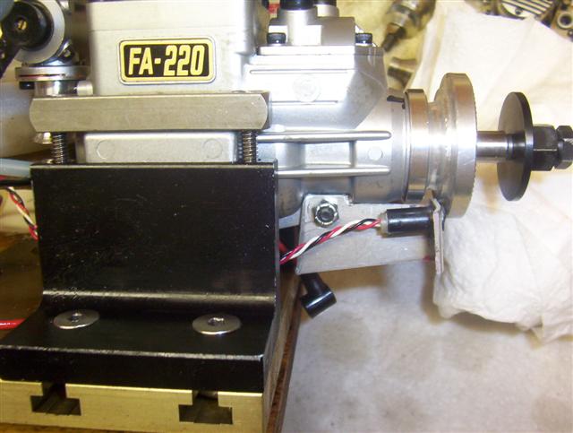

I have owned somewhere between 15 to 25 Saito,s. That said, this Fa 220 is not your father's Saito. The tank is on the CG so it is equipped with a Perry VP20 pump. It gets plenty of Wildcat 20-20 fuel.
I primed it wet and sloppy and then applied glo-starter. I was surpised that my Hobbico 180 starter turned it over easily and it started right up. (needle valve open 3 turns). Throttled up to about 1/3 after letting it warm for a minute. Dropped back to high idle and removed glow. Engine died.
Restarted, throttled up to about 1/3 and removed glow. BACKFIRE! threw prop and spinner destroying both.
What do you think? Too rich? Too lean?

To keep it from killing your plane you should put it in a test stand and run it for about 40 minutes plus get the LS needle set, I have a proven procedure for both if interested.

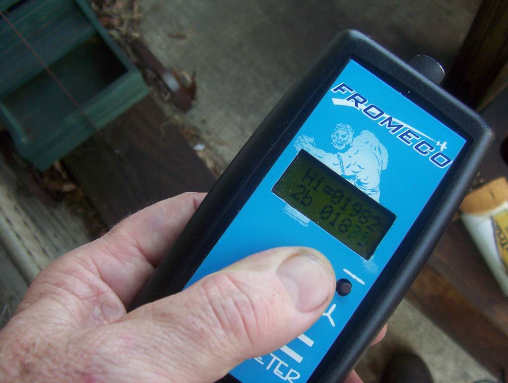

Sorry, I didn't know how much or how little "sperience" you have, I should have asked. You're right about the 2.20 being a little intimidating, it swings a big board pretty hard. I've had my Davis Diesel Jumbo Chicken Stick removed from my hand more than once. I installed a CH ignition on my 2.20 but so far haven't been able to equal the glow plugs power.

On glow I do the backflip on ignition I forward flip, the CH SynchroSpark retards to 6 degrees BTDC at cranking speeds. It doesn't even offer to kick back.
