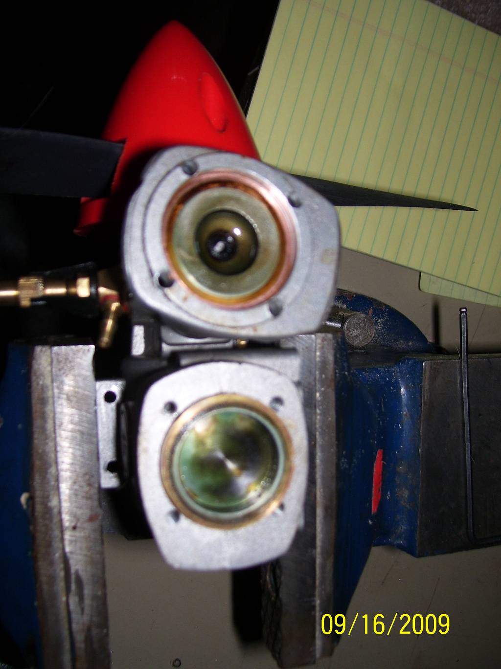

Hello All,
I popped the head off of my ST45 for the first time this morning and was very surprised to see a dark green tint on top of the piston and on the head. I'vebeen using Cool Power 15% most recently. Is it normal for an engineto take on the colorof the fuel it is using?

LET'S TRY THIS PHOTO THING AGAIN!

If your engine is the ABC version....you better add a couple of ounces of castor oil to the cruel power.
And yes, that's pretty normal, but you'll see some colors more than others... Cool power oil is green... so green is what you see, and looks like the green dye is the only thing that remains on the engines using coolpower, while the oil dissapears .
I used to dye my fuel, and the color remained inside the engine. Other than that there is nothing to worry about.

Morgan Fuels; the manufacturer of 'Cruel Power', [link=http://www.morganfuel.com/omega_main.htm]recommend[/link] using their own Omega fuels, for engines with an ABC, or an ABN P+L.
Your Super Tigre is an ABC engine, so I cannot understand why you selected this 'fuel' for your engine.
I would go a step further and recommend staying away from Cool Power and most other all-synthetic American made fuels, unless you are happy replacing your bearings often, or running your engine unprotected...
Sig Champion, or PowerMaster GMA (50/50 oil, 20% and 22% respectively), are even better fuels.

I am fully aware of the construction type in my ST45 but was not aware that Cool Power was inadequate for the ABC type engine. Thanks for the tip, you can bet I'll be using fuel with at least some castor blend. I have been happy with Wildcat Premium Xtra 10 / 18. I usually bring up the oil another 2 % to an even 20%.

Add 2.5 ounces of high quality castor oil to the fuel and you'll be fine.

I've seen the insides of engines tinted blue, green, pink and purple...
Blue Thunder and Monster Horsepower (purple ) are car fuels...
