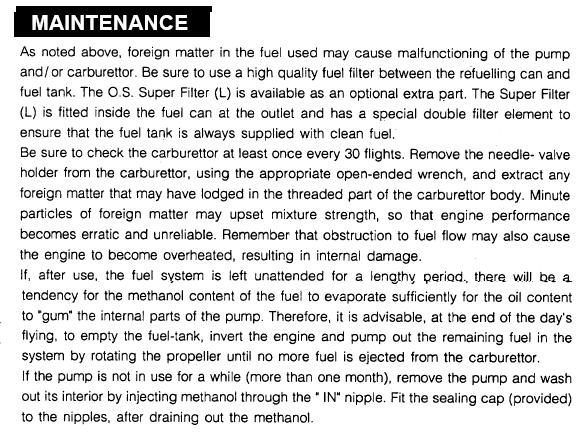

Alan, are you sure that you don't have a bad throttle servo (hunting)?
You should not leave your onboard ignition on when the engine is running peaked out. It is hard on the glow plug and it doesn't do the engine any favors.
Why are you accumulating goo in the carb at thirty flights? I'd investigate that issue (dirty fuel) before I changed anything on the engine. The OS 1.40RX is intended to be used at a competition engine. I can't imagine any pattern flyer putting up with an engine that needed to be disassembled every thirty flights. Many pros put more flights than that on their model in a week. That would consume a lot of their time. I suspect there were certain qualifications to that 30 flight period that we have missed.
Good luck. You have a great engine.

on the manual says that one has to clean the pump after 30 flights.Gum is normal on glow engines beacuse the menthnol avporats leaving the oil.i will check the servo aswell.Does it have anything to do if the pipe lenght is not right?
Alan

on the manual says that one has to clean the pump after 30 flights.Gum is normal on glow engines beacuse the methanol evaporates leaving oil with turns in to crystals(the engine is filltered which i cleanned) .i will check the servo aswell.Does it have anything to do if the pipe lenght is not right?
Alan

Do not remove the pump!!!!!!!!!!!!! while it looks easy with four bolts the backing plate is the back of the pump. if you remove it you may never get it back together again. 160.00 mistake that may well be.
Yes you can inject straight methonal into the pump at the inlet i use a regular syringe like for filling up a control line plane. i just go slow with it. I have run these engines for over a thousand flights. the only time i ever flush the pump is at the end of the year. I run a sullivan crap trap filter from the tank to the pump. and of course a filter in my fuel can.
I do not run onboard glow and the engine is mounted inverted also. I normally use powermaster 15/16 mixed 50/50 with powermaster 15% mean and green. I have also used coolpower 25%. S&W 22.5% Wildcat 15%Helimix and Wildcat 15% all with straight synthetics. My favorite fuel for it is 15/16 which is a 15% nitro with 16% synthetic. just can't get it anymore. I do not take the carb apart to clean it when i flush the pump it goes out the carb.
Also at the end of the day i do not run my engine dry i just drain the fuel. and put the plane away.
The most important thing to remember about the 140RX is the rear bearing. usually the stock bearing will go bad in about four gallons of fuel or 40 flights that will most definately affect the midrange and idle qualities. I replace my stock rear bearing using the OS140CFI bearing as soon as i get the engine i do not use the stock bearing.

What kind of oil are you mixing to make your fuel? I like castor in fuel, but if it is getting sticky, you might need some pure synthetic oiled fuel(after run fuel?) to run through before you put it up at the end of the day; that and run the engine dry. The 30 run clean up sounds like lawyer talk for i dont want to fix it.
