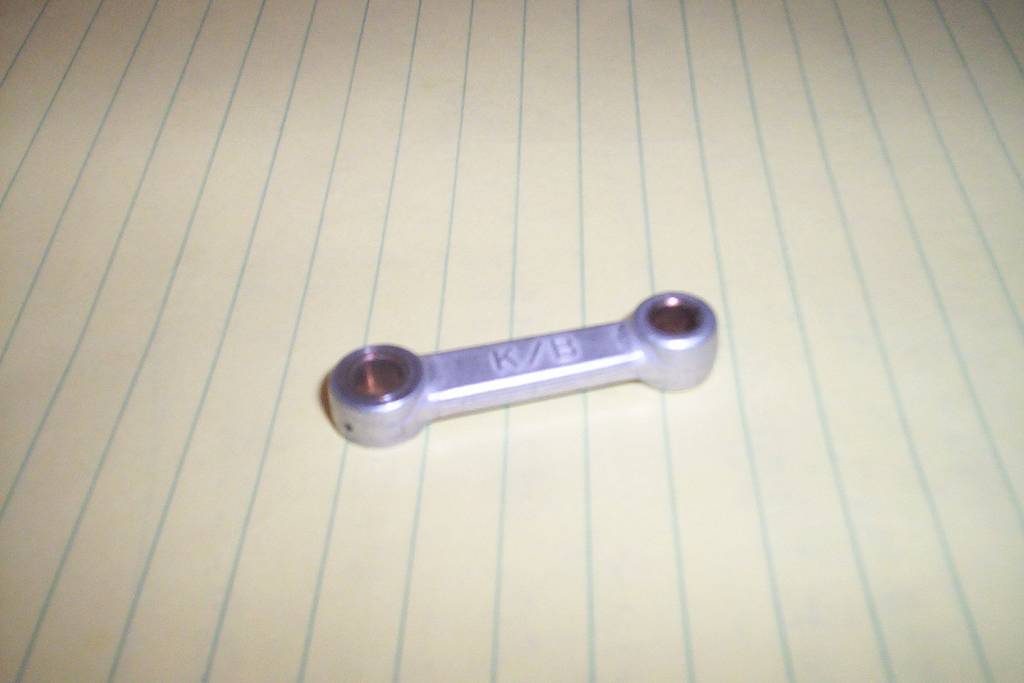

I've got all the bits and pieces lined up to make some rods now. What I have to work with is a lathe and a drill press with a cross slide vise.
I can also use a table saw as a dick sander .
Now, could someone please outline my order of operations.....a plan of attack?
I've never had to do any precision work before that had to have repeatable and predictable results, such as maintaining perfectly centered holes, working with home made bushings, etc.
This is the cast rod that I'll be duplicating.

What kind of bar stock are you using? Rectangle ? Round? It makes a difference in how you start.
If using round stock, the first thing you are going to have to do is mill a flat surface to drill the holes for the bushings and press them in. The lathe will not be much help unless you can clamp the part and use the cross feed like a milling machine with a mill bit chucked up in the lathe head.
If using rectangle stock, it's a little easier. Your first concern is centering and aligning the holes for the crank and wrist pin. Make sure your bar stock is square and has no twist, mark and drill the holes for a press fit for the bushings. Once the holes are complete, its just a matter of removing the matterial you don't need from the rod to get the shape and final dimensions you want. This would be easier with a vertical milling machine and small surface grinder. But if you're very carefull, you can do it with a drill press, milling bit, and a cross feed vise. The hardest part will be clamping your part at the angles you need and squaring the vise travel with the mill bit. Like I said earlier, I'm not a small engine expert, but I'm not a novice machinist either. Hope this helps.

Jerry, I'm using flat aluminum plate and I've got some bronze round stock.
I'd like a step by step out line of the key tasks involved. Not ever little detail, just the sequence of the key tasks.

Ok, so you're going to turn your own bushings out of the bronze round stock? Do you have a small boring bar or know how to make one? Or are you planning to just use a drill bit to get the I.D. in the bushings?

The way I machined the bushed end was to machine the inside diameter of the rod to the O.D. of the bushing. I turned down the bronze and pressed it into the rod then re-machined the hole to fit the wrist pin.
The overall "wall thickness" of the bronze will make it tough to press it in the rod without deforming it. You're better off pressing it in as a solid pin and machining out the hole to fit the wrist pin leaving a thin bushing behind.
Just my opinion...

One reason I asked how he plans to get the I.D. in the bushings is the dimensions he said he needed for the crank and wrist pin and the tools he has availible. If he has drill bits that will give him the correct I.D.s, then pressing them in as a solid piece and drilling the I.D. will be best. If not, then he will need to use the lathe to bore out the I.D., then turn the O.D. to match the hole he has drilled in the rod end, and use a brass or wood mandrel to help press the bushing into the rod without deforming it.
