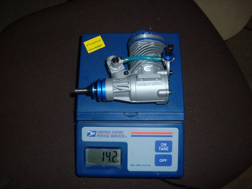

Kostas,
You know you are just going to buy an OS anyways. I just picked up my NEW EVO .60NX tonight. I needed a little 14 oz engine to get the Sundowner 50 cranking.

Yes indeed,
but right now i am going to save as much money as i can in order to also buy in the close future the newly designed Hangar-9 DeNight 40 ARF [>:]
I want to ask if the blue pieces are indeed like wheel collars and can be removed as long as you remove the screw that holds them in place.

Kostas,
I know it will be powerfull, since it has timing optimized for aftermarket tuned exhaust systems (FROM ENGINE MANUAL). I will not be running mine for a while. We are in the midle of a very cold winter. It is 15 * F outside currently. I would of put a you know what "TOWER .75" in it, but I am trying to keep it really light, and this is quite a bit lighter than any other .60+ other than a Jett.

They come right off just like you mentioned. I tuned one for a friend several years ago, and the only complaint I had with it was that the limiter kept me from leaning the low end where it should be. I quickly removed them, and I had it purring!!!!
