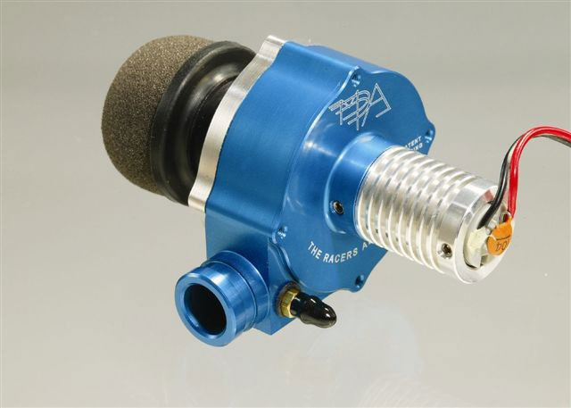

hey my name is casey i was wondering where the hell did ya get that electric charger i want to buy one so email me at [email protected] with the info on where to buy one thank you very much dude

The Superchargers are available from
http://www.rbinnovations.com/

hey man do you know where kmot got that that blue electric supercharger and where i could find one let me know

The electric supercharger was produced by a company in Arizona called "MPPA". I forget what those initials stood for. Something like "M........ Performance Products A............"
Anyway, they went out of business years ago.
