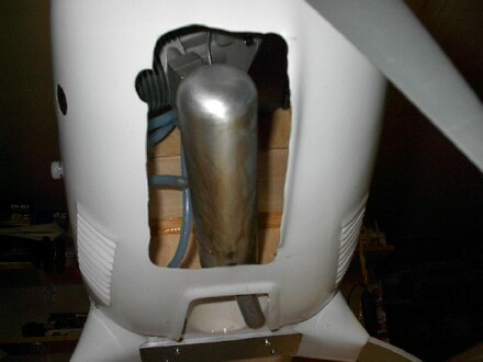

I have a Moki 210 in a WM Extra 300s and I am having trouble with overheating. Engine runs great with cowl off however with cowl on It runs bad and hot. I have enclosed some pics of the setup and I am hoping somebody can tell me what the problem is.
Pic 1 shows that the left intake is closed. Also the head sits a little lower than the intake.

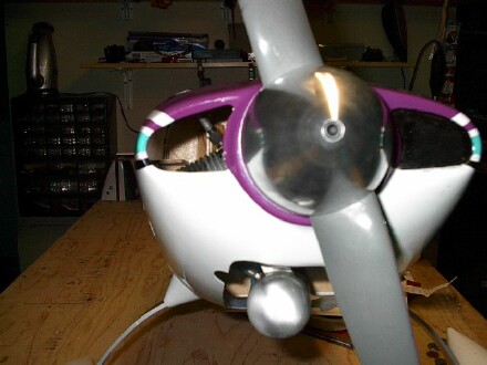

Default Help. Moki Overheating.
Pic 2 shows the huge outlet for air.

Default Baffle
Crash90,
Your engine may need baffles to route the air, that comes through the cowl "nostril", around the cylinder and the head of the Moki.
Because of the helical propwash "shape", the air coming through this intake may have enough "down" quadrant, to miss the cylinder altogether.
Even full size Lycoming and TCM engines have such baffles installed.
Block of the redundent cowl in take, it's doing nothing any way.
Try a baffle plate from the good intake as suggested above. You need to force the air "through" the cylinder. As you can see clearly in your photo, the air is going over the cylinder, not through it!
If that dosn't help (it will) try this...
because you have set the moki at an angle, cut a sub hole underneath the cowl intake, directly infront of the carb and cylinder head. This doesn't need to be big, infact it get less efficient (I run fully cowled YS 1.40s with an intake size if 1x2cm and a very big outlet area. Perfect) 2x3 cm will be fine. Try that for a while. Infact , that could work so well you may even block of both cowl intakes.
Remember to keep the nitro low ie.5% with a Moki

From: Georgetown, TX
I have a BGX installed in a 300s almost identically to your setup. I have the intakes on both sides open, but use baffles to direct the air to the engine. It runs beautifully without any sign of over heating.
John
That may not take care of the overheating. Baffles are needed in many aircraft due to the amount of air space behind the engine. This can cause a high pressure area in the cowl which can push the incoming air away from the path you need it to flow. I'll still post the pictures as I know this is a subject which has come up from time to time.
John

Posts: 6,897
Default Baffle pics
Here are a few pictures of my 28% Extra 300s with BGX. Note, I installed the baffles after first flying the model due to overheating. The air hole below the stock opening was present since before the very first flight. The last picture shows the main air exit. it's about 3.5" X 5" long. There is more space between the bottom of the cowl and the bottom of the engine box than appears. Also note the over head shot with the lower half of the cowl installed and how much space has effectively been eliminated by the baffles to prevent air stagnation behind the engine.
John
Head on without the cowl.
3/4 above without cowl
Side view without cowl
[IMG]http://jndneff.home.texas.net/rcplanes/DSCN0050.JPG
[/IMG] Over head with lower cowl installed
Head on with lower cowl installed
Underside of lower cowl with air exit

Default Baffling baffles...
John,
It seems like the baffles in your aircraft are intended to extract the incoming air out of the cowl.
What our friend here, Crash90, needs are baffles that would route the incoming air, over the engine's head and cylinder cooling fins, before being drawn out.
The baffles you have shown are also needed, of course.

Posts: 6,897
The baffle behind the engine is in deed intended to direct the air to the bottom of the cowl to be expelled. This is every bit as important as directing the air to the engine, which, is what the baffle on the aircrafts left side of the cowl does. It directs the air from the left side opening towards the engine.
No matter either way though. Crash 90 has his engine mounted, in his first post, exactly as I have mine mounted. The conclusion here is "What works for the goose will work for the gander".
