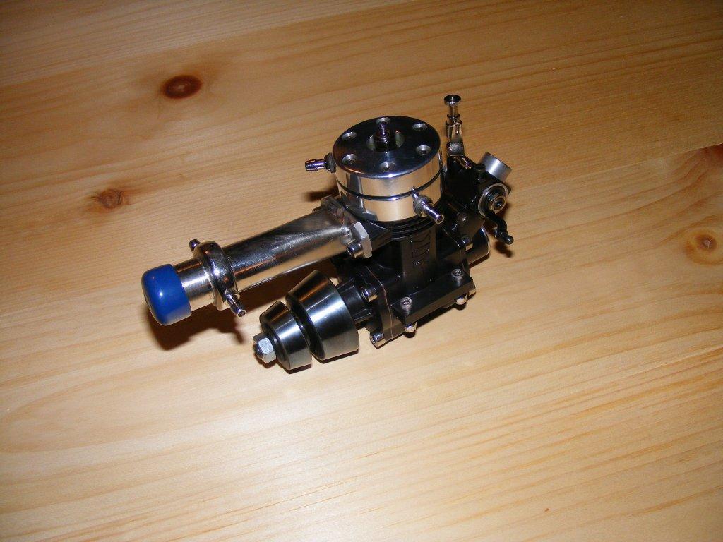

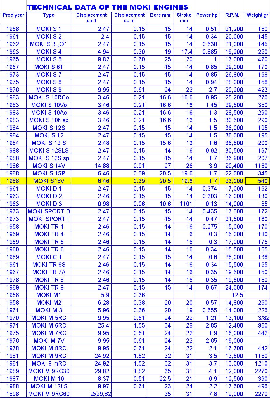

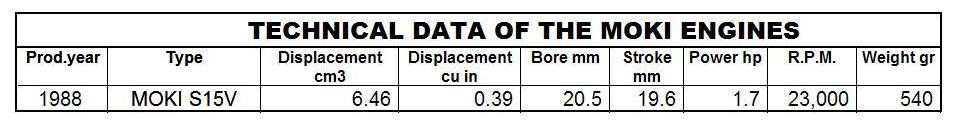

!!! MOKI !!!
My only one and I love it.
1988 Moki Model S-15V
6.5cc (.40cu in.)
It arrived with less than a half-gallon of fuel through it but was gummed up and stained badly and had spraybar damage.
I rebuilt it with ceramic hybrid bearings, stainless steel fasteners and ceramic paint.
I replaced the carb with a SuperTigre SUPG1803 until I rework the original.
The motor is going into a Dumas U-71 Atlas Van Lines 40 hydroplane.

Jetpack..what you do with your engines should be called ART!
