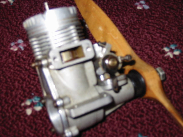

Hi, i have aquired this engine. It has no markings on it. It has a very strange carb with a flat sided spray bar and a weird backplate that goes all the way up above the exhaust port. It's a 40 sized engine. It's got so much compression that I almost can't turn the crank over by hand without a prop installed. I don't think it's ever been ran. Can anyone shed any light as to what it is? Anyone know what it might be worth?

It was made by Fox Manufacturing of Fort Smith, Arkansas. Very powerful for its day. The carb adjusts backwards, in that you adjust the low speed needle first and then the high speed needle.
I liked the flat blade carb, once I got used to it.

Looks like a Fox 40. The butterfly carb dates it to before my R/C days. I would guess mid-70's, but perhaps someone can give you more specific details.

OH, you asked about value/worth.
I'm thinkin' somewhere around the $35.00 to 50.00 US dollar amount.

Although this is for the 40BB and it appears you have the bushing version, this instruction manual should help you to break in and set up the carb. The older Fox's took a while to break in.
http://www3.bc.sympatico.ca/fliteline/40-2jet.html

Use that engine...don't sell it for peanute.
The Fox .40 will still outperform most current .40's and it's lighter as well.
The lapped piston takes longer to break in, but it's like an old cast iron frying pan.....ever seen one wear out? Me neither.
Good engine...crappy muffler.

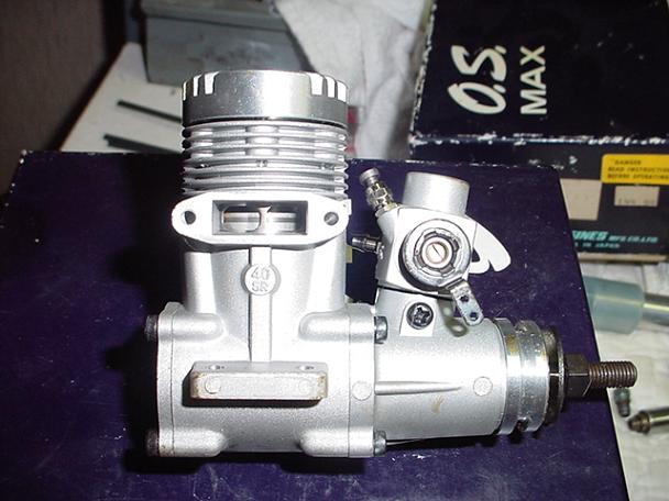

....these OS .40 FSR's might have come out a little
before you guy's time...(snick snick)....

Old 07-18-2003 | 12:05 AM
My Feedback: (12)
Posts: 5,133
From: Pampa, TX
Default Does anyone recognize this engine?
That Fox came out a little before them FSR's.
Looks just like mine...a almost NIB 40 FSR AND a OS 45FSR...

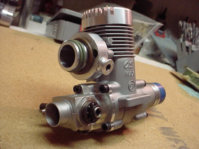

Default I'm an FSR Lover myself....
....however the .61 SF, and RF series engines are
outstanding....
....all the "V' series engines are outstanding....
Yo, Mike....I have a couple .40's for a Duelist....
the .45's really cranked....
I don't even wanna tell you guys about the last Fox
powered (or lack of) plane i saw fly....it's too sad.
I forgot to mention the NIB OS 40 V rear intake/exhaust I have sittin here...my bad

It's a Fox .40, I just got a Fox .15 from the early 70s that has the same throttle, except the .15 has the carb cast as part of the crankcase. I can't get off the topic on this one because I've never owned an OS.

You have a 70's vintage Fox bushing bearing 40 with an antiquated butterfly carb. I had the exact same engine, but with the newer carb, back in about '83. It was an OK engine, hauled my many times rebuilt Epoxy Stick around until I sold it to get a more modern engine.
There was nothing spectacular about it, it served me long enough to learn to fly, and long enough to realize that there were much better engines than a bushing Fox 40.
I would place a value on it of about $25~$35, maybe $5 more if it had a muffler.
I think it would make a much better conversation piece than a flyer, if you decide to run it be sure to run fuel with castor oil only as the lube due to the piston/bushing material used. 22~24% castor, 10% nitro ought to be just dandy.
Hope you enjoy your vintage Fox engine.
