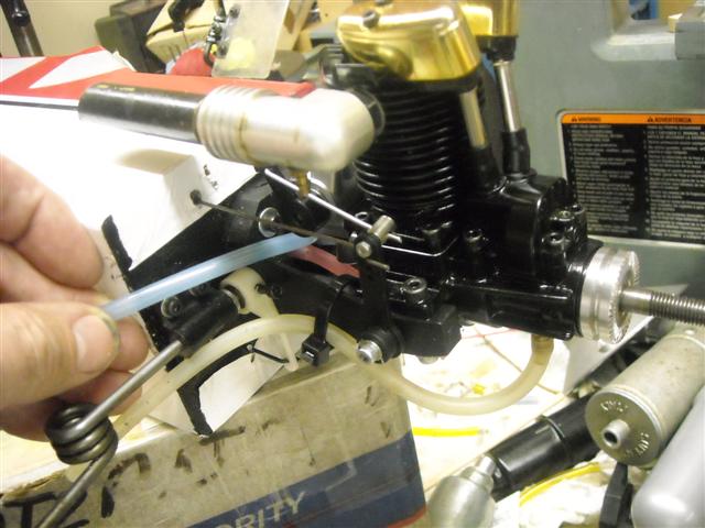

OK, its eazy peazy, get this engine mount and four 6x32 blind nuts and four 6x32 socket head screws. Don't use the wood screws that come with the mount. The .56 will fly your plane with ease in fact a Saito .40 will fly it.
http://www3.towerhobbies.com/cgi-bin...&I=LXJ772&P=ML
I'll be back. This is my .56 in an RCM 40, I get a little fancy with the throttle. You can just run a wire out past the carb and bend it 180 back to the carb and it will work just fine.

Shags, my RCM 40 is nearly identical to your plane in the spec department. The RCM has a 63" span. I have flown it quite a bit with an old Saito .40 and a Graupner 12x5, I've also flown it with a Saito .62 and a Graupner 12x7, with the .62 it will do loops where it is nearly out of sight at the top. I use a Graupner 12x6 or Bolly 12.5x6 on the .56. The reason for the side mount is it will get an LA .46 Diesel conversion next. The beauty of the GP mounts is limitless engine mounting possibilities.
Get a longer engine mount for a few dollars and throw that Saito in her, should be easy peasy. You will certainly enjoy the flying alot more when listening to that beautiful music the fourstroke makes instead of that annoying weeeeeee.... sound of the twostroke.
I swap my engines around alot, never seem to decide which I like the best. After flying a twostroke in a certain plane for a while, I swap it out for a fourstroke, and after a while again I swap that one for another twostroke and................on and on
I always use the stock mounts that come with the planes and drill holes to fit both two and fourstrokes. All it takes is to move the fourstrokes a little forward and re-route the throttle linkage some. No big a deal really
The Saito probably weighs slightly more than the LA. That and the fact that the Saito mount will put the engine forward enough to clear the firewall means you may need to move the receiver battery to get the CG correct. If you use one of the plastic mounts it will save some weight up front.

You know, I said at the beginning that I didn't want to make this post about my OS46 LA. But that seems to be the direction it has gone, I think because of my dissatisfaction with that engine. But my post was about replacing it with something I would consider an upgrade, i.e. the saito 56. Still, I responded to the querry about the LA, but I did not come on here to complain about it. Because as I said before I'm done messing with it. As far as I'm concerned that would be like beating a dead horse - just no point to it. So you can get your panties all in a knot if you want to because you don't like my "complaining" as you put it. But you wont convince me that the one I have is little more than a cheap crappy engine.
I want to fly not tinker. And the only experiment I want to do at this point is replace it. If I were a betting man, I'd bet you a 100 to one that a new engine will mount in this airplane with no other modifications other than break in and mounting and will run reliably no problem. And I wont have to put armor all in the fuel nor put sealant around the back plate either. But again I digress... and there's little point to it.
I'll mount up the saito when I get the mounting sorted out and let you know how my little experiment goes.
shaggy
shaggy
