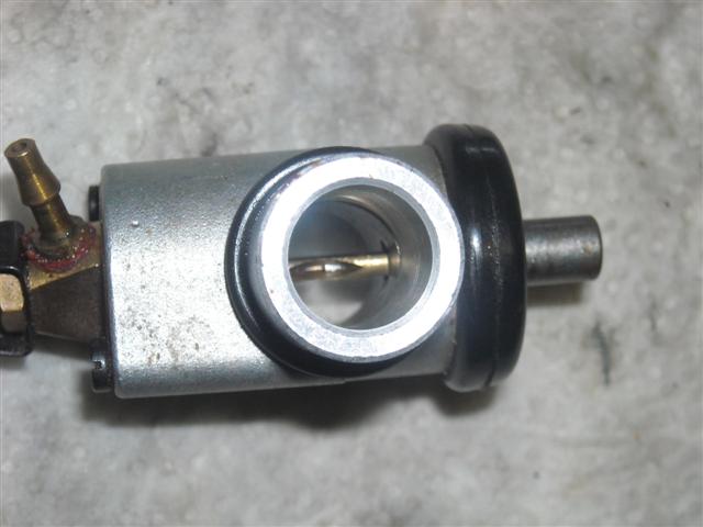

ed , i have a ?, does the fuel spray have to flow through the exact center of the cats eye on the carb. because, if you
put it there your going to have a rich idle, or am i wrong?

Old 08-26-2013 | 01:12 PM
Hobbsy's Avatar
My Feedback: (102)
Posts: 20,370
Received 30 Likes on 28 Posts
From: Colonial Beach, VA
It will end up about right there.
Name:	SuperTigre spray bar 004 (Small).jpg
