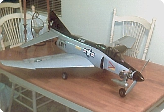

Every Irvine post is an advertisement!
I always say "The Irvine-53 and YS-45 are the finest engines I have ever owned..."
Of course I now have a Jett-50 and it is a masterpiece but kinda $$-
Galen- the same Galen that has the F-4 Prop-jet? If so, is yours still alive?
I piped my YS-45 (Macs 7.5CC) and now it is frightening
Hope all is well,
james
