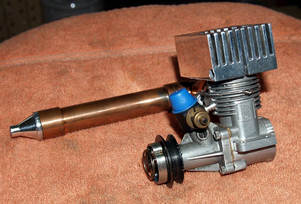

bought an hb, made in germany motor. it's a .15 and feels like it has no compression. this is a lapped piston engine i think. guy says it only runs castor fuel and needs to be broke in for two hours. it sure don't run very good on regular 15 % cool power. i say it's worn out. he says no way. but the motor runs real hot and won't hold an rpm. acts like some engines i have had that were worn out and ready for a new piston and sleeve. didn't build any compression on two tanks of fuel i ran through it on a test stand. can't keep it running steady enough to put it in a plane thats for sure. has a perry carb. is this engine a ...relic.....like the old fox lapped piston engines of the 60's and not up to moderen spects like os,super tigre, thunder tigre etc...........thanks for any input guys..............RON

Running a lapped engine on cool power will kill it, the hot running is from friction. Lapped engines need castor for lube. It can be a pain finding castor only fuel for sale, I know, but it is a requrement for engines like this.
I agree with rcdude7. Some time ago I was doing a test run on an old lapped piston engine and accidentally used a fuel with 20% all castor but luckily I was monitoring the head temp. When the temp started to soar past 300F I had a DUH moment. I filled the tank with the 25% all castor I meant to use and then all was sweet
Fox and one or two other companies make a fuel with more than 20% castor so wait until you can get some of that before running it again, it may still be OK.
.Fox and one or two other companies make a fuel with more than 20% castor so wait until you can get some of that before running it again, it may still be OK.
You might buy some Castor Oil and up the oil content ( a test) See if it acts better with the more oil. Then you might invest in a different fuel. I run mine on 5% nitro and either 20% Castor or 22% Castor/ Synthetic Blend. HB's like low nitro content. The HB 15 is a great engine if there is any of it left. I hope you still have a decent engine.

As stated previously, Cool Power is a killer for lapped piston engines. I ran Power Blast 12.5% nitro that had a good bit of castor oil as the lube. I forget what the ratio to synthetic was, IF there was synthetic at all.
If the case is in good condition and everything is present, it might be worth it to replace the sleeve and piston and start all over again. I have over 20 of these engines. That might tell you how much I love them. I've never found another .15 that is as light, runs so well and handles as much like a pattern sixty as the HB .15. If you want to see some serious screaming, put a 7x4 on it, not that it won't pull more prop, but it sounds like a rabid Rossi with the 7x4 up front.
The engine is an easy hand starter and will out last its owner if castor oil based fuel is used.

If you're lucky you have just mated the surfaces and when it gets the right fuel it may run fine (I have seen that happen on a similarly abused Enya engine). In the worst case you have worn it out and it needs a new piston and liner.

There is/was nothing wrong with that "relic" engine apart from the fuel that you have feed it.

Well, there is some good info to be had here in this thread. The leason is: Don't run a lapped piston engine if you don't want to use the right type fuel in it.
Some people on this board swear by synthetic lube as the superior lube choice, but most engines will benefit from at least some castor in th mix. Some will cringe when I say I even run some castor in my YS fourstrokes

Have you ever heard of engines having a "green" piston?
Some of the old OS lapped piston engines came through with loose pistons that actually "grew" into the proper size needed. I am not kidding.
I have broken-in several HB .15 engines. None of them had fuel with pure castor oil lubricant. I was blissfully unaware of that need, but I used to add lab grade castor oil and nitromethane to my fuel, except for pattern engine fuel. That I did not want castor in because of the mess and the very heavy flying schedule of those models.
Anyway, get some fuel with some castor oil in it, or add some castor oil on your own. Be aware that these engines need to be ran in slobbery rich. When you can run the engine peaked out (minus a few hundred rpm) for a minute, then you are ready to lean out the mix a bit. You have nothing to lose except some time and some fuel. Unless you're stupid enough to try to fly the engine through break-in. I've been that stupid on several occasions.

With lapped pistons you need to use castor oil, more modern lapped piston engines can do well using a blend of synthetic and castor oil, but are best with 100% castor oil. For a new lapped piston engine you need 25% oil, but it can be reduced in a broken in engine. Old timey engines can use upwards of 33% castor oil in them, with 25% being the minimum. A old well used mapped piston engine needs 25% castor oil at the minimum and you do not clean the piston and cylinder either as the old varnish is actually helping improve the compression. If you ran a fuel with 100% synthetic oil through a old varnished up lapped piston engine, it will remove the vanish and the engine will loose all of its compression and you can't put the varnish back on by then, it is too late.
I think the little HB .15 engine was one of the sweetest engines in its time. A modern .15 runs circles around them, but the HB .15's were just such gooid runners though.
Cool Power fuel is Ok for use in a modern plated cylinder ball bearing engine, but never use it in a older lapped piston bushed crankshaft engine, it will quickly destroy the engine.
You likely ruined the little HB .15 doing that.
