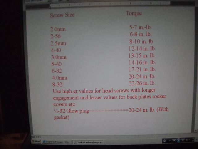

Hi All,
When putting an engine back together after tear down, are there torque specs for the different bolts like the head bolts or back plate bolts? If so is there a small torque wrench that you use?

I've seen numbers around 11 in-lbs for head bolts, the same ought to work for backplate bolts.

11 is pretty high for 50 sized engines, 7 is about right and 4-5 for the back plate bolts. For M4 bolts 10 is good. I have a chart if anyone is interested.

I halve these numbers for most heads and quarter them for most backplate bolts. Glow plugs, I do at 22 inch lbs. At first 22 seems like a lot but I've never had one strip at that setting. The Tork-It wrench came from here.
