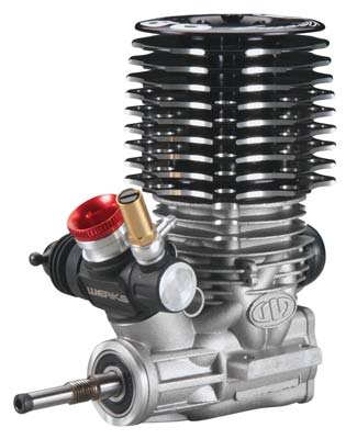

I am wanting to do some bench testing on some of my car engines. The best way I can figure to put the same amount of "load" on each engine is by using a prop from a plane and then take RPM readings off of the prop. but I am not sure how to attatch a prop to a car engine that has an SG shaft. I could use a threaded clutch bell and drill the hole in the prop out enough to get it to fit over the threads but I am not sure how i would get the engine started from there since all my engines are bump start only. can this be done somehow? Does anyone have any ideas for me?
Also, any one know of a tach that reads higher than 32,000 RPM? Some of my engines will crank out over 40,000 RPM and the mini hand held tacks I have found only read up to 32,000 RPM
How do I get this
Attachment 2236647
on this?
Attachment 2236648

Sure, it can be done, all you need is a prop-driver and a different carb.

                 if the engine has the std 7mmØ shaft the cheapest way is to buy a super tigre 27 prop drive and collet.Make up a std venturi about 9mm for a 21.DO NOT use any thing but a carbon fibre prop,i use a Sherlock 7x4 prop for test use,my sts 21 turns 30k plus.

I've wanted to do this same thing for a long time to break in my car engines, I think it is probably the best way to break in any engine, but especially ABC engines. The crankshafts on my .20 smallblock car engines only 5mm, and its probably too short to boot. My big block engines (.26 and .28) are probably long enough, but the crank isnt completely threaded so putting a prop nut/spinner on it is out of the question. I think a different crankshaft may be in order to make this work, at least for me anyway..
The prop driver is one thing, that probably would help clear the carb... But getting/keeping the prop tight to the crank is gonna be the tough part, as I see it.

earlwb 01-31-2012 05:45 AM
RE: Prop on a car engine
You need to either find a prop driver/thrust washer and collet to fit the crankshaft, or make one up on a lathe.
Then you may need to make a special prop nut and washer to fit the threaded part on the crankshaft. it depends on how thick the propeller is. Usually you make a spinner nut with a long shank on it to fit the threads and then you ream out the prop to fit the shank on the spinner nut.
The prop driver washer may allow enough clearance to work with the car carb, but you may have to flip the carb around and angle it. Otherwise you have to use a different carb.

APC and other manufacturers limit their props for safety reasons to 190,000/diameter. They can explode at RPM's over that.
That means an 8" prop is limited in capability to under 24,000.
The extra airflow from the prop over the large car heatsink means the engine will never reach operating temperature so your break-in won't be proper.

What Thumbskull said was my first thought too. Your engine would run cold, and not work properly. Years ago I had a Heli engine that I used in a plane, I could never get it to run right in the plane, but ran great in the heli. <div>
</div><div>Why not attach a flywheel to it instead? Use the clutch setup you normally would, and use a large balanced weight for the flywheel. Drive it with a belt.  You wont have the hazard of a prop exploding, and you can run it up to top speed. </div>

Could Novarossi: 29062 be the answer? I haven't tried it, but it looks like it´s intended for this.

Thanks for all the replys. I am going to order that run-in test set from novarossi and see what I can do with it. I may also try to rig something up using the standard flywheel,clutch and clutch bell setup to a spur gear on a lock center differential and attatching a prop to a driveshaft somehow. I have abunch if soare parts from an 8ight 2.0 buggy that I am pretty sure will work. If I go that route I won't have to wory about the prop getting anywhere near the carb, and the prop won't be directing airflow over the engine so i will be able to get it up to proper operating temps.
Also I'm not nessassrily doing tis for break-in. I am wanting to test different engines to see the rpm potential of each engine and by running diffeent props I will be able to determine how much power different engines have relative to each other.
