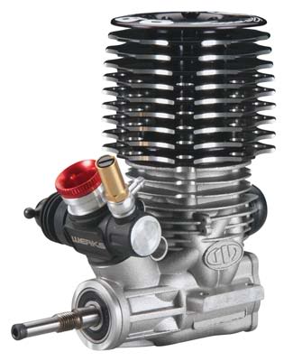

I am wanting to do some bench testing on some of my car engines. The best way I can figure to put the same amount of "load" on each engine is by using a prop from a plane and then take RPM readings off of the prop. but I am not sure how to attatch a prop to a car engine that has an SG shaft. I could use a threaded clutch bell and drill the hole in the prop out enough to get it to fit over the threads but I am not sure how i would get the engine started from there since all my engines are bump start only. can this be done somehow? Does anyone have any ideas for me?
Also, any one know of a tach that reads higher than 32,000 RPM? Some of my engines will crank out over 40,000 RPM and the mini hand held tacks I have found only read up to 32,000 RPM

The prop driver is one thing, that probably would help clear the carb... But getting/keeping the prop tight to the crank is gonna be the tough part, as I see it.
Edit: Here's the crank from the Super Tigre .27 Airboat engine.
Here's the crank from my SH .28, and Traxxas 3.3
SH
TRX 3.3
If I could fit a prop to one of these without having to change crankshafts, I'd break all of my engines in on a test stand instead of in the car.
You need to either find a prop driver/thrust washer and collet to fit the crankshaft, or make one up on a lathe.
Then you may need to make a special prop nut and washer to fit the threaded part on the crankshaft. it depends on how thick the propeller is. Usually you make a spinner nut with a long shank on it to fit the threads and then you ream out the prop to fit the shank on the spinner nut.
The prop driver washer may allow enough clearance to work with the car carb, but you may have to flip the carb around and angle it. Otherwise you have to use a different carb.

APC and other manufacturers limit their props for safety reasons to 190,000/diameter. They can explode at RPM's over that.
That means an 8" prop is limited in capability to under 24,000.
The extra airflow from the prop over the large car heatsink means the engine will never reach operating temperature so your break-in won't be proper.

I would think a custom prop would be the ticket to handling the higher rpm of a car engine.
I personally dont think car engines ever break-in to run at their peak the way they are outlined by the engine OEM to be broke in. As I understand it, ABC, AAC, and ABN engines should be run at or slightly faster than the RPM they're expected to run at during normal use during break-in, though slightly rich. Running 1" smaller dia. prop and setting carb rich enough to run at that rpm is how Jett recommends breaking their engines in. I ran my TT .46 in this way and its still getting better every run and its at about 1.25-1.5 gallons now.
What Thumbskull said was my first thought too. Your engine would run cold, and not work properly. Years ago I had a Heli engine that I used in a plane, I could never get it to run right in the plane, but ran great in the heli. <div>

Could Novarossi: 29062 be the answer? I haven't tried it, but it looks like it´s intended for this.
http://www.novarossi.it/eng/products/accessories/

Thanks for all the replys. I am going to order that run-in test set from novarossi and see what I can do with it. I may also try to rig something up using the standard flywheel,clutch and clutch bell setup to a spur gear on a lock center differential and attatching a prop to a driveshaft somehow. I have abunch if soare parts from an 8ight 2.0 buggy that I am pretty sure will work. If I go that route I won't have to wory about the prop getting anywhere near the carb, and the prop won't be directing airflow over the engine so i will be able to get it up to proper operating temps.
Also I'm not nessassrily doing tis for break-in. I am wanting to test different engines to see the rpm potential of each engine and by running diffeent props I will be able to determine how much power different engines have relative to each other.
