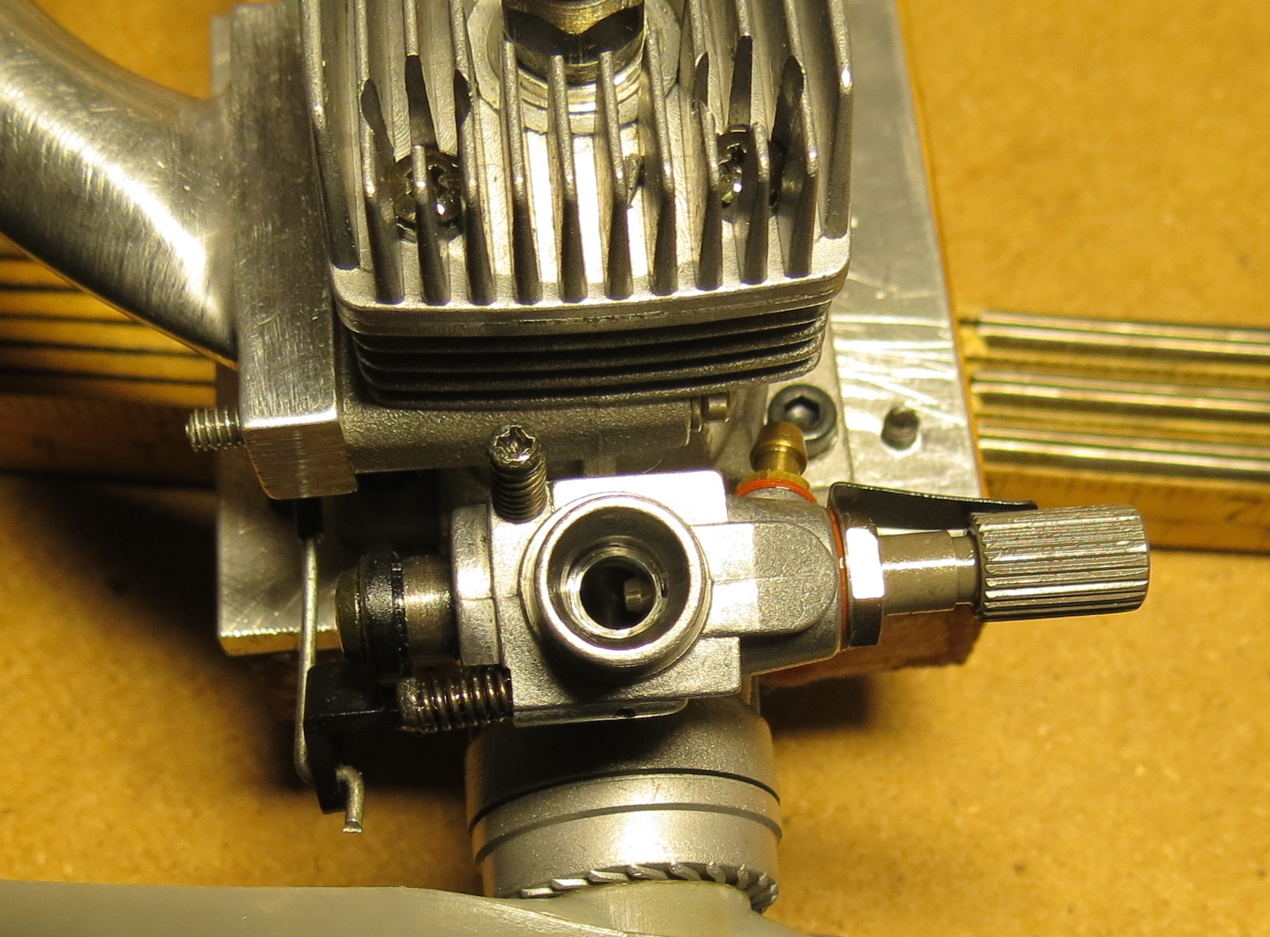

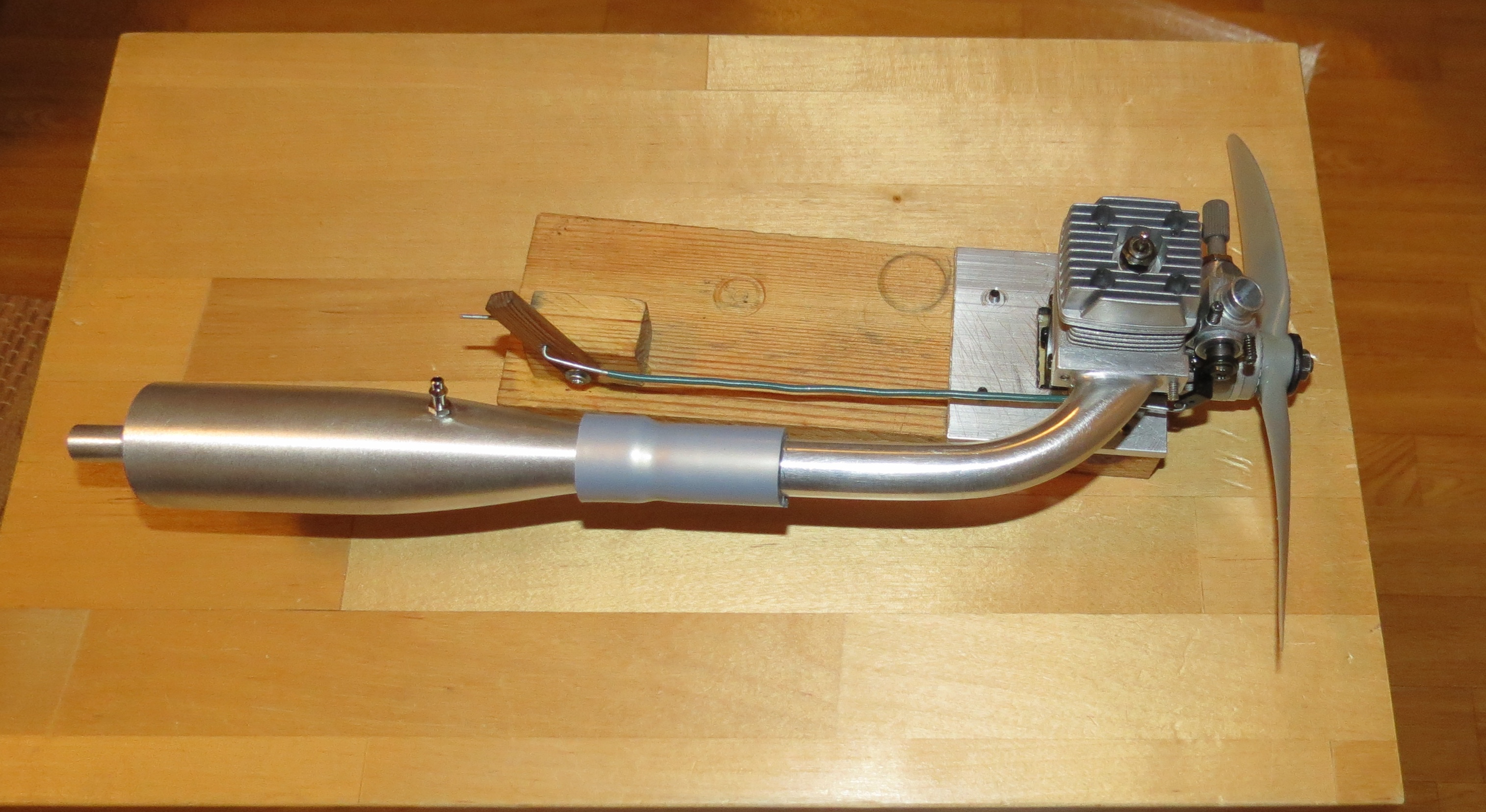

Just a little update on this engine. I've had it put away in box with a few other engines that I haven't been happy with...
I have it running fairly well now and there is nothing really wrong with the engine, it just doesn't perform well straight from the box with the supplied muffler. I've tried to measure the timing and intake is fine (opens about 38° ABDC and closes 49° ATDC), while the exhaust is quite long (around 157°) due to a large chamfer on the piston. So long story short, it mainly just needs a better exhaust.
The carb also has a rather strange restriction in the lower part which is smaller than the barrel opening. I've removed that but ended up reducing the barrel opening instead.
So with a Mac's header, and a car style muffler, it now spins an APC 7x4 at around 20000rpm (10% nitro and an extra head shim) and throttles fine (low end is a little too rich though). So I guess it runs as well as a good .15 engine and there is probably more room for improvement too.

20,000 with a 7x4 isn't super strong but is good power for a stock engine. open the card up see what it will do with a 7x5 APC. open the carb on a LA15 and add another port in the sleeve and the case and can get 19,500 open exhaust with it.
