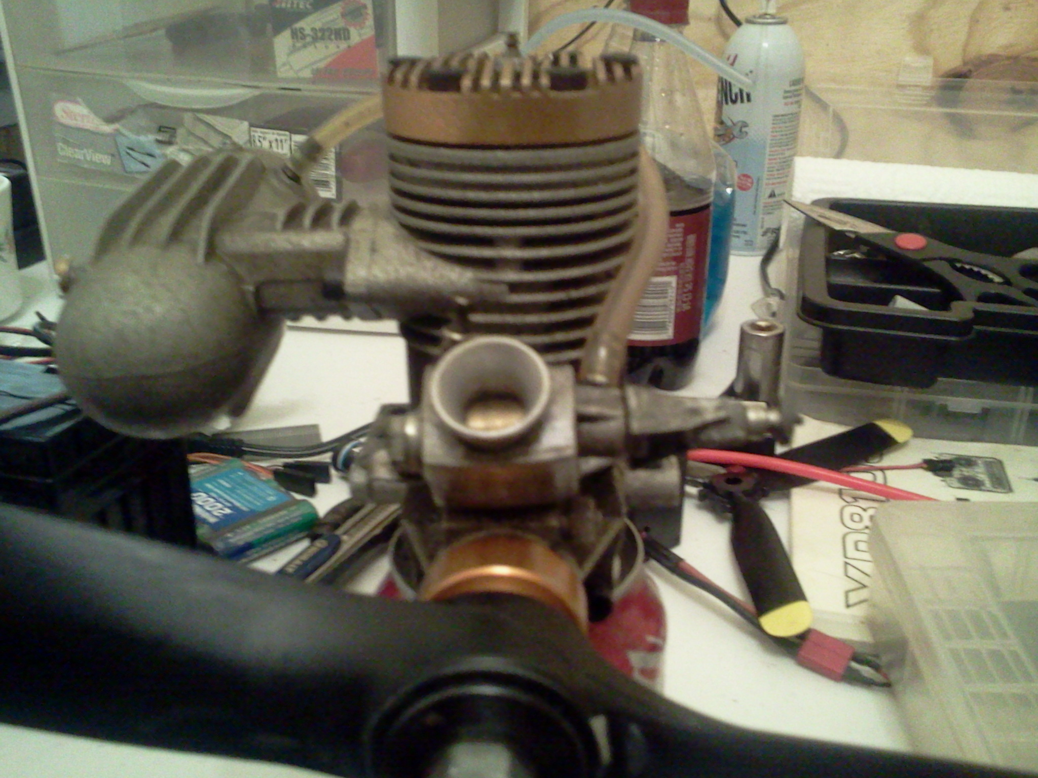

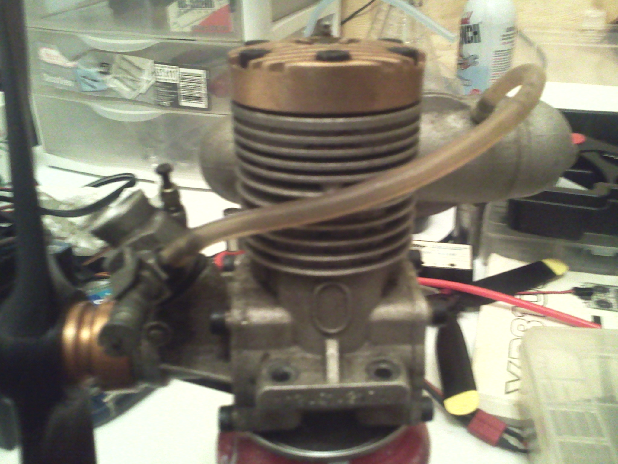

Need help identifying this 2 stroke.
numbers on the left hand mouthing lug, . 12.91.2194
http://www.rcuniverse.com/forum/atta...mentid=1946499http://www.rcuniverse.com/forum/atta...mentid=1946504http://www.rcuniverse.com/forum/atta...mentid=1946500http://www.rcuniverse.com/forum/atta...mentid=1946501http://www.rcuniverse.com/forum/atta...mentid=1946502http://www.rcuniverse.com/forum/atta...mentid=1946503
The head and prop hub appear to be anodized bronze color.
Thanks, y'all.

Those Numbers make me think MDS from Russia?
Someone's copy of a older OS design? Sort of like a old ASP
earlwb 12-10-2013 06:48 PM
Some of the earlier Russian engines used numbers stamped into the mounting lug on the crankcase like that. It is likely a Russian made engine. Probably a early MDS variant before they started putting MDS on the sides of the crankcase. The carb on that engine looks like a MDS carb which they loosely copied from OS at the time.

MJD 12-11-2013 04:02 PM
I'm almost 100% sure it is an MDS .61. Many features the same - though not identical - as mine which is another 10 years older. The engine lug numbering system is identical, the muffler design almost identical, the prop hub is the same profile, cylinder head fin pattern the same.

It is a "not-for-export" sandcast MDS engine made in the late 70's. The circle on the side is different from the Russian versions which have MDS written on the side. As such, it may be an East German version.
Max
MJD 12-12-2013 04:52 PM
It looks like the numbering on the lugs is month-year-serial number, but I've never confirmed that. Would 1981 make sense for this example? Hmm, the OP says it is 91, but it looks like 81 in the picture..?
