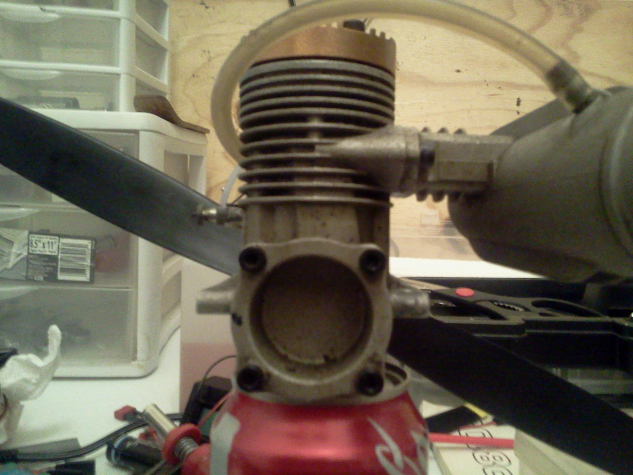

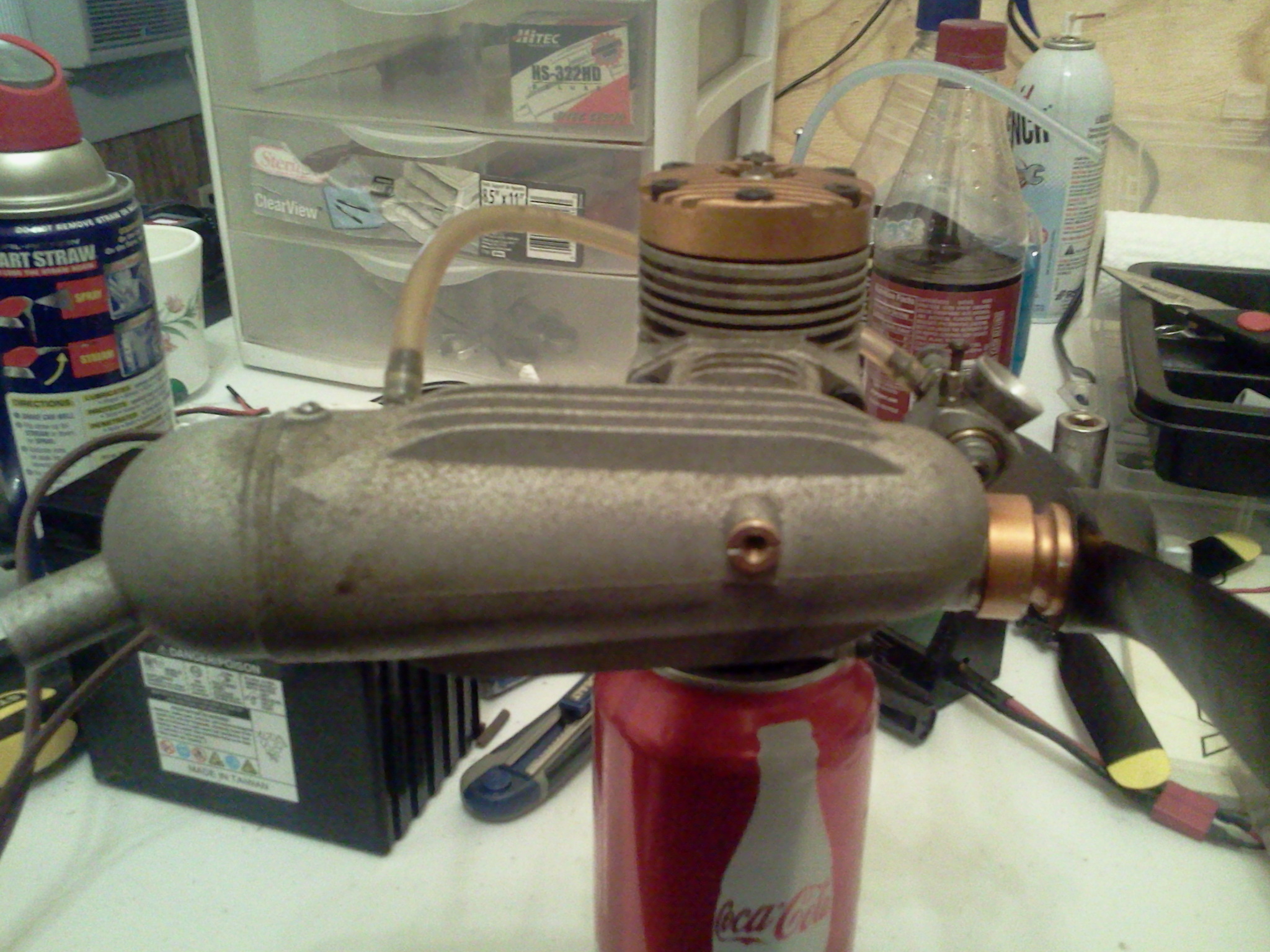

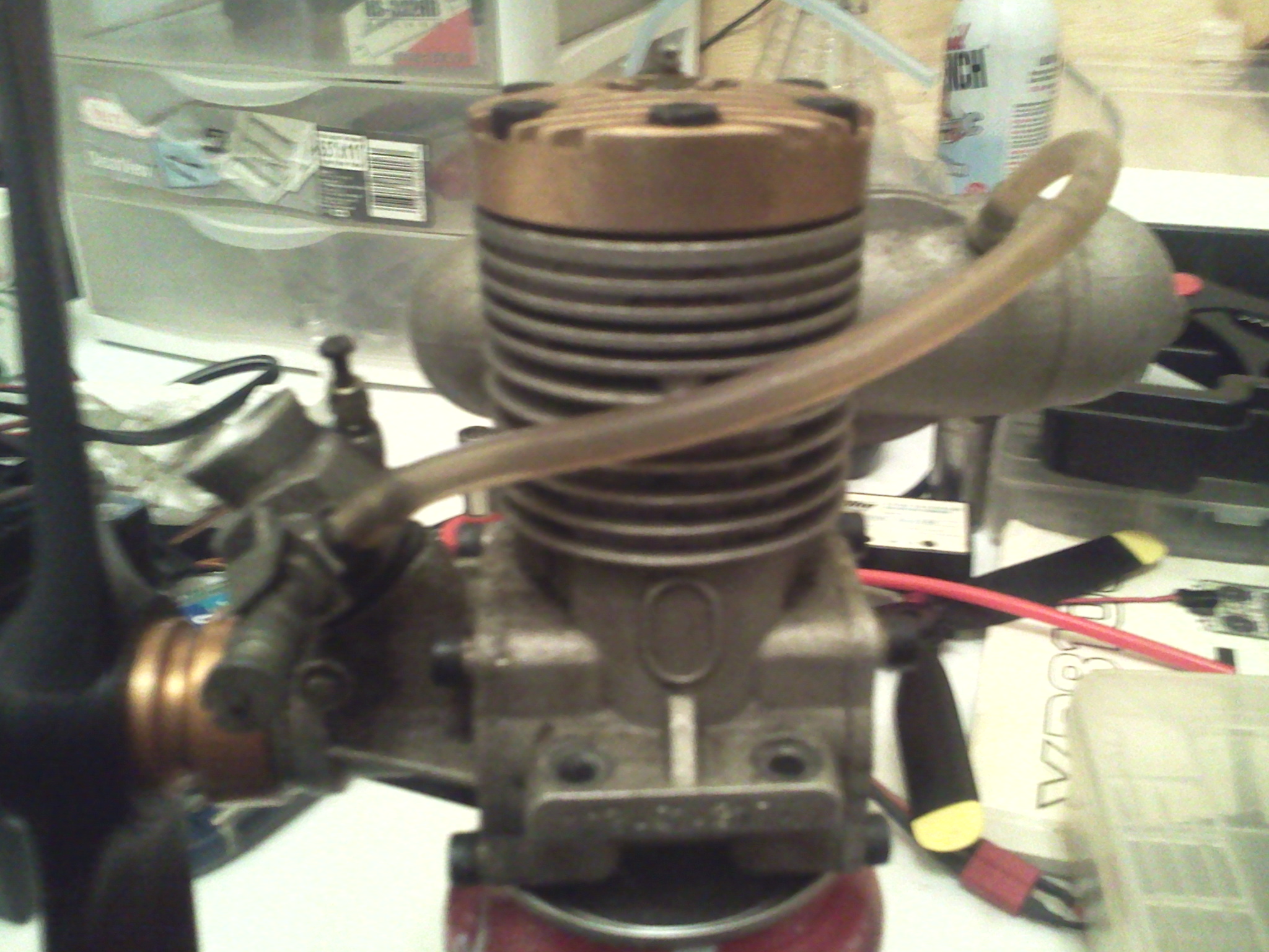

Need help identifying this 2 stroke.

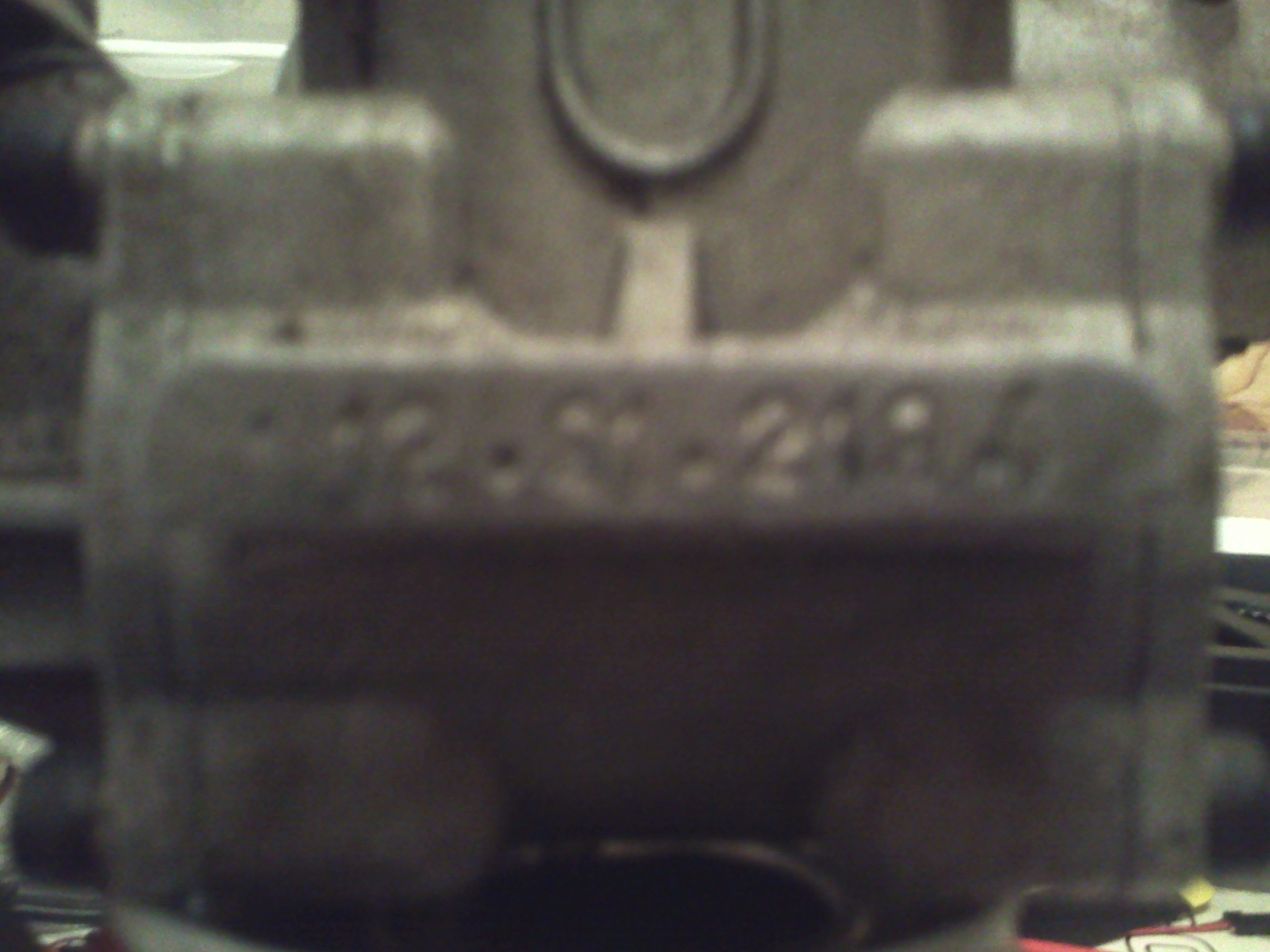

numbers on the left hand mouthing lug, . 12.91.2194
The head and prop hub appear to be anodized bronze color.
Thanks, y'all.

Those Numbers make me think MDS from Russia?
Someone's copy of a older OS design? Sort of like a old ASP
Old 12-10-2013 | 06:48 PM
earlwb's Avatar
Joined: Aug 2009
Posts: 5,993
From: Grapevine, TX
Some of the earlier Russian engines used numbers stamped into the mounting lug on the crankcase like that. It is likely a Russian made engine. Probably a early MDS variant before they started putting MDS on the sides of the crankcase. The carb on that engine looks like a MDS carb which they loosely copied from OS at the time.

The OS .91's are in a .61 case like the Super Tigres, right? If so it could be a 10cc/.61ci. More likely to be a .61 than a .91 based on how old it looks. It's probably ABC?

You should be able to see through the exhaust port. If it's ringed there will likely be a bridge in the exhaust port in the center.

I'm almost 100% sure it is an MDS .61. Many features the same - though not identical - as mine which is another 10 years older. The engine lug numbering system is identical, the muffler design almost identical, the prop hub is the same profile, cylinder head fin pattern the same.
If it is like any other MDS, keep the nitro down. 10% max, 5% better. And less prop.

I had one I got it from Great Hobbies for $99.00. It is a MAK .61. It is true ABC with a sleeve timed between normal and pipe. Quite a screamer. They made a rear exhaust version too.

It is a "not-for-export" sandcast MDS engine made in the late 70's. The circle on the side is different from the Russian versions which have MDS written on the side. As such, it may be an East German version.

It looks like the numbering on the lugs is month-year-serial number, but I've never confirmed that. Would 1981 make sense for this example? Hmm, the OP says it is 91, but it looks like 81 in the picture..?
