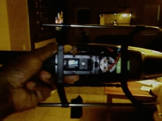

Right after I first bought my Axe I did away with that crappy stock antenna set-up. With what I have now I can just pop off the antenna and do an R&R on the skid supports. It only take me five minutes to change them out. If I had to mess with that entanglement they call an antenna wire I'd get peeved too.
Here's my set-up. A modified [link=http://helihobby.com/html/extras.html]Micro-Z antenna[/link]. I used the OE antenna tube for mounting and added shrinktubing to the outside of it to increase durability. Aside from the $13 for the Micro-Z there is no downside.

Here are a few pic's of the Helimax MX400 skids on my AXE. One other thing you have to do is route the ant wire to the other side as the ant tube mt is on the left side. They are thicker then the stock AXE landing gear too.
Bob..

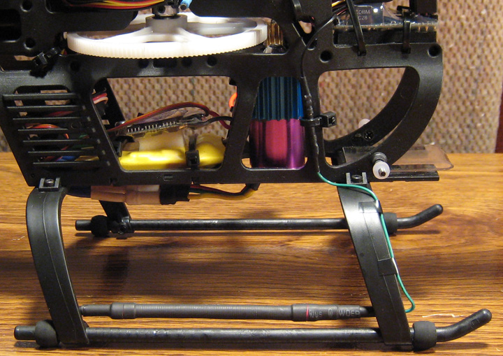

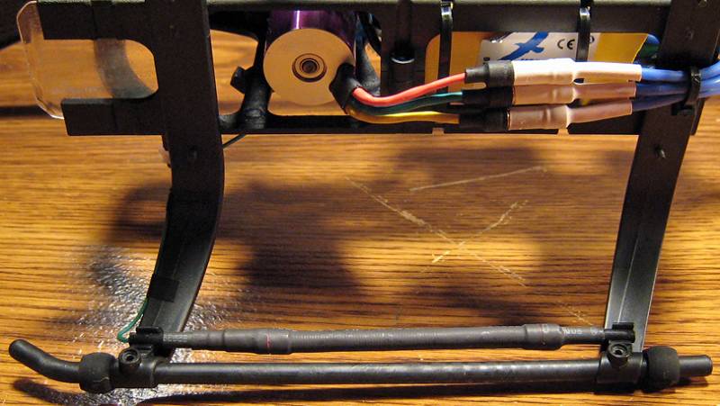

I put the landing gear for the Align 450 on my AXE CP and it looks and works great. Best of all, much stronger than the stocks. Here are some pics, tell me what ya think:

Old 08-13-2007 | 11:37 PM
Heliko's Avatar
Joined: Jan 2007
Posts: 591
From: Colorado Springs, CO
Default RE: Skid Support Question! Please Help
That's looks pretty cool DK.
I may have to do that as well just because the aluminum skids look so much better then the stock ones.

The Align gear I put on my Axe CP works very well. I have no regrets about switching to the T-Rex 450 gear what so ever. I paid about $9 for the set.
