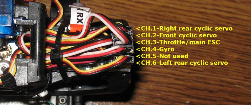

Could someone tell me what servos plug into what jacks on the 3n1 (you'd think the manual would have this info!) Also, what is the 5th connector used for?

channel 5 is usually for a HH gyro, but the axe cp Tx does not have that capability

If you mean the Rx then here you go.
