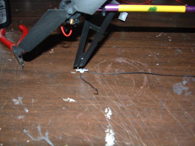

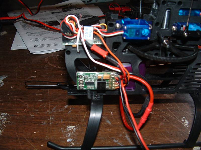

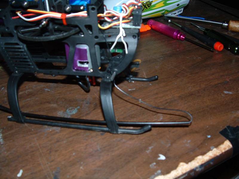

Old 03-18-2008 | 09:26 PM
Joined: Jun 2002
Posts: 3,717
From: high deserts, CA
Default RE: Helimax axe cp Problem
I was getting so much radio interference I moved the Rx and the 3 in 1 around until I stopped getting hit. I moved the 3 in 1 to the left side and secured with double sided tape. The Tx is on top. I have only had 1 hit since I moved it all around.
Now, if I can only get it to stop getting blown around by the 15-20 MPH winds I am trying to fly in. It is almost like flying a parachute in the wind.
Dru.
