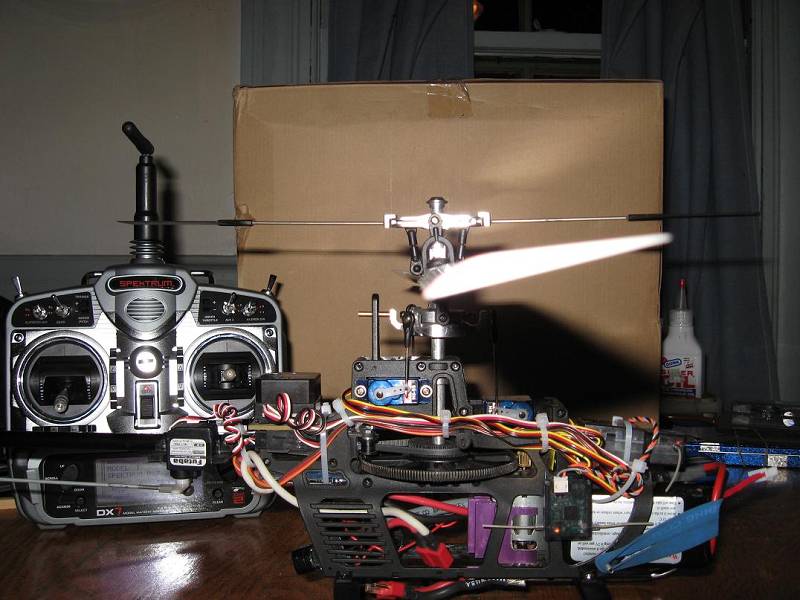

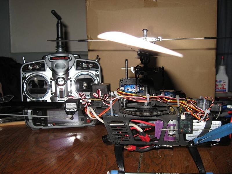

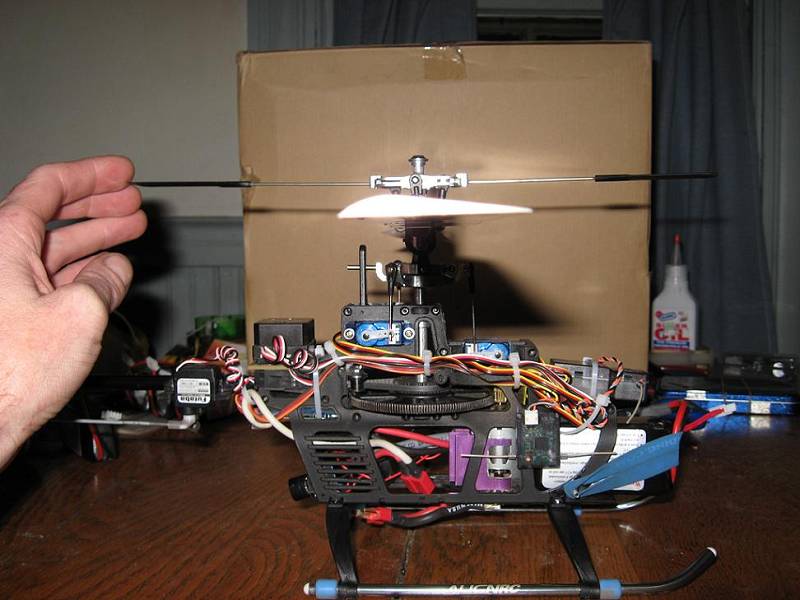

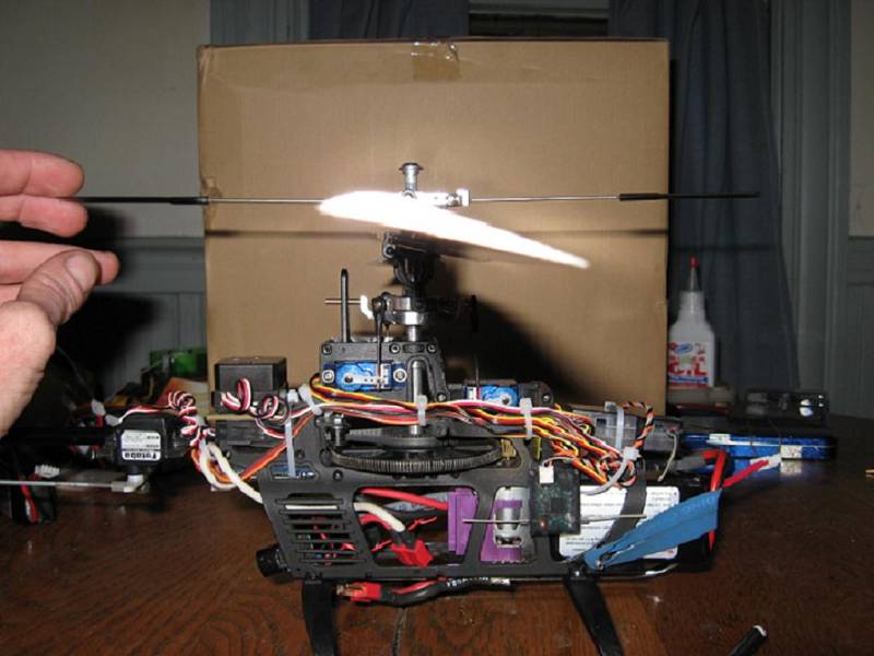

Blade balance WILL DEFINITLY affect your collective performance, however the noise you are hearing IS coming from the blades & it's OK! That's the blades beating the air around them, both my birds the MX300 (was an AXE CPv1) and my T-rex 500 make that BRRRRRAAAAAAPPPPPPP noise when both climbing and upon fast desends with collective pumping. The BIGGER the BLADES the LOUDER the noise!
You SHOULD go through ALL the screws on the ROTOR HEAD & LOCTITE them ALL! Loose screws will END your Heli Training "Quick, Fast & in a Hurry!" I would also go through the pitch set-up again (using a pitch gauge) to make sure your getting at least 10' postive & 10' negative pitch, your swashplate height could be off, leaving more pitch on one side than the other.
The reference pics show Normal Mode low & high & Idle-up high & low.
The reference pics show Idle-Up Mode High & low & Normal mode low & high.
