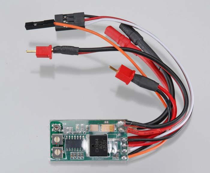

Fried an eboard the other day, installed a new one and Im having a heck of a time getting it set right, cant seem to slow the tail motor down, any ideas???

Looking at my old Eboard, with the pots on the left side:
The top pot turns around without stopping, so I can't tell you where to set it.
The middle pot will turn from 10 o'clock CW around to about 8 o'clock. Mine's set to about 6 o'clock.
The bottom pot has the same end points and is set to about 2 o'clock.
Be sure your wires are connected to the proper slots on the receiver.

K, I think I may have them in the wrong spots, you dont happen to have a diagram do you?

Old 04-21-2009 | 01:17 PM
PilotLight's Avatar
Joined: Aug 2003
Posts: 1,027
From: Benton Harbor, MI
Default RE: Axe CP E board settings
Here's an image from Towerhobbies:
Turn the middle one all the way clockwise until it stops, then back it off until it is vertical like the picture shows.
Turn the bottom one horizontal (it can only be horizontal one way and can't be upsidedown), and then turn it Counterclockwise until it is pointing at about 2 o'clock.

ORIGINAL: albramley
No pic my freind??
Alright, I uploaded a pic instead of linking to one on Tower's site. Also, I added little red marks where mine are set to. Be sure you still have your eboard mounted vertically.

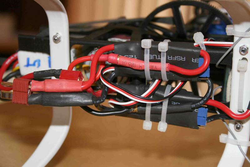

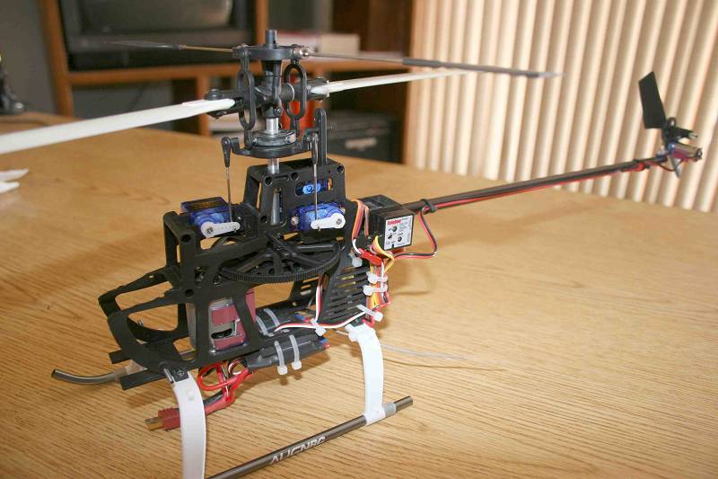

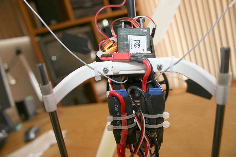

Here are a few pics of an Axe I modified to run with 2 Eagle 30A esc's and a Telebee gyro.
The port esc runs the main motor.
If you do this, remember to remove the red pin from the plug where the tail motor esc plugs into the gyro. The gyro gets its power from the receiver,
which gets its power from the main motor esc. This is covered in the later Axe manuals.
This Axe has a Futaba receiver. I have not tried this setup with an Axe receiver, but it should work.
About the front of the frame - I cut away the frame so a 1300 mAh lipo would fit as shown. The
canopy mounts with plenty of room and the cg is very close to perfect.
All in all, this Axe is really a pleasure to fly. The 7 channel Futaba radio works well and the dual rate/exponential settings
make the Axe much easier to fly.
The Eagle esc's are available from www.hobbyking.com.

Al,
Each esc has 4 single wires and a 3 wire cable hooked to a servo connector.
For the single wires, 2 go to the battery and 2 go to the motor, main or tail.
So you have 8 single wires plus 2 three wire servo connectors to deal with.
I soldered the battery connections to a Dean's plug as shown in the pics, both positive battery connections
to one tab, and both negative battery connections to the other battery plug tab. This takes care of 4 wires.
For the main motor esc, I soldered bullet connectors on the two output wires going to the main motor, as on the stock Axe.
For the 2 output wires from the tail motor esc, I used a small Dean's connector as used on the stock Axe.
OK, you've dealt with the 8 single wires
Plug the main motor esc servo connector into channel 3 of the receiver, where the 3 in 1 plugs in on the stock Axe.
This connection powers the receiver and all the servos and the gyro from the BEC (battery eliminator circuit)
built into the esc.
The servo connector from the tail motor esc is going to plug into the after market gyro. The gyro will also have a
servo connector that plugs into channel 4 of the receiver, where the orange wire goes on a stock Axe.
The instructions in the Axe manual for installing a gyro tell you to remove the red wire pin from the tail motor esc
connector that plugs into the gyro. There is a little plastic tab on the servo connector you can lift up with eg
an exacto knife and the red wire pin is easy to pull out. You can see where I've taped the red wire in the pics.
So the ground and control wires from the tail motor esc are hooked to the gyro and this is how the gyro controls the
tail motor.
Good luck, and I'd like to see your pics if you make these modifications.
