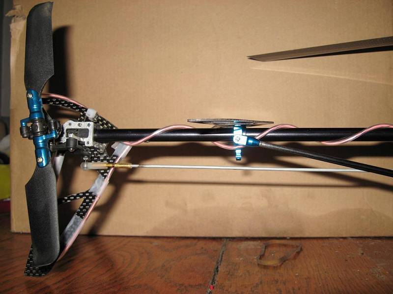

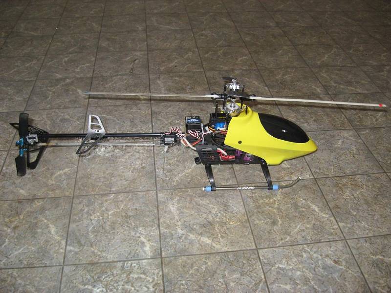

I did a Belt driven tail on my AXE CPv1 several years ago, and have never looked at an electric driven tail till my nano-sized Walkera 4g3, and I converted that to BL within the first week. I 've included a few pics of the BDT system on my MX300 (was an AXE CPv1 at one point in time).

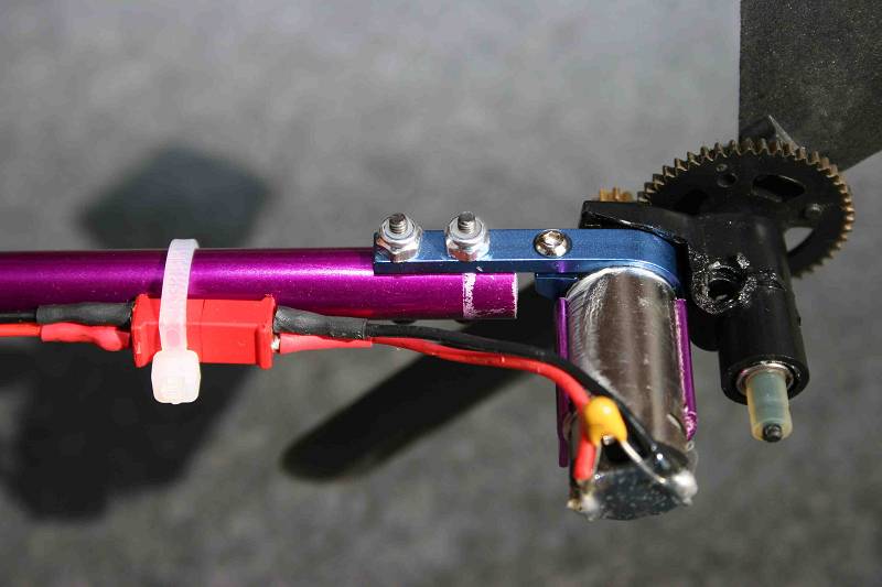

></p><p class="MsoNormal" style="margin: 0in 0in 0pt"><font size="3">With any luck a picture will accompany this showing how to use an Align 12mm boom servo mount to mount the tail motor.<span style="mso-spacerun: yes"> </span>This is a big help.<span style="mso-spacerun: yes"> </span>It is stronger than stock so you won't be breaking tail motor brackets and it provides more of a heat sink.<span style="mso-spacerun: yes"> </span>You can use it with geared or direct drive.<span style="mso-spacerun: yes"> </span>I would stay with the geared drive.<o

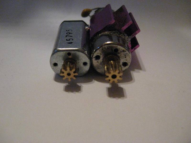

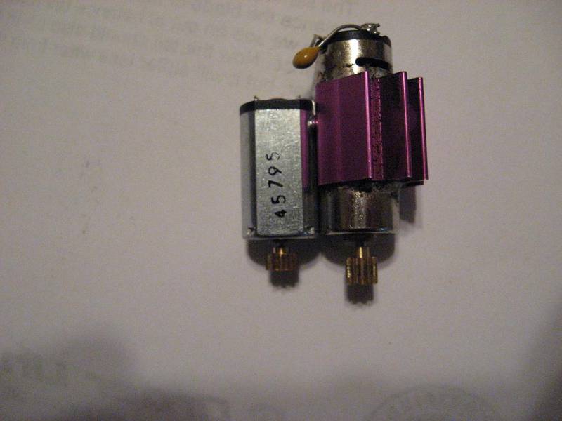

any idea why the tail motor costs 25 bucks for both the geared and the direct drive when the main motor is only 15? i saw the blade cp pro has a direct drive motor that looks like it might be the same for 10 bucks?

The tail motor off the Blade CP Pro will work fine, even though it's slightly smaller. See the comparison pics below, the BCPP is on the left, the stock AXE CP tail motor on the right.
