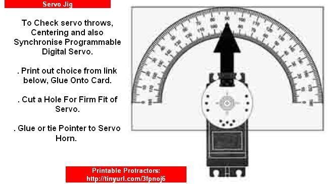

Easier if Rx, servo(s) and battery are on the bench for tests such as centering with the attached jig:
Hitec Eclipse 7 will turn Hitec &amp;JR servo clockwise when CH 1 &amp;Ch4 sticks &amp; trims are moved to the right and
CH 2 &amp; 3 sticks&amp; trims moved upwards.<span style="font-size: x-small;"> </span>(Futaba servo and clones thereof will turn anti clockwise).
