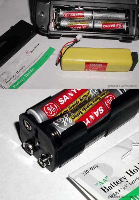

I was thinking of getting a new battery for my Eclipse.. the battery seems to not last long on my Eclipse.. I am new to this hobby .. i have a Corona electrice heli and all I do is practice hovering.. Once i was going to practice and I was adjusting the blade tracking and the radio started beeping and showing battery low.. so what is the mah of the stock battery and what would you suggest for an extra.. NiMH?

after further research i found you can use an 8AA battery holder form Radio Shack and use regular NiMH AA batteries.. i have some Sanyo/GE 1600MAH batteries that i use for my digital camera so i used those.. below is a pic for anyone that wants to go this route.
