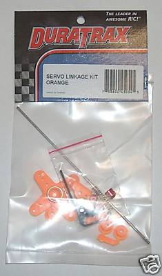

Ive got alot of work to do with my savvy. Ive received today the throttle/brake mod kit that I bought off fleabay, but need a picture of how to do it as it dint come with instructions, im sure it'll be easy, but just would of liked to see it assembled.
This be the mod...

you'll have to search for that one. mine are still stock.
