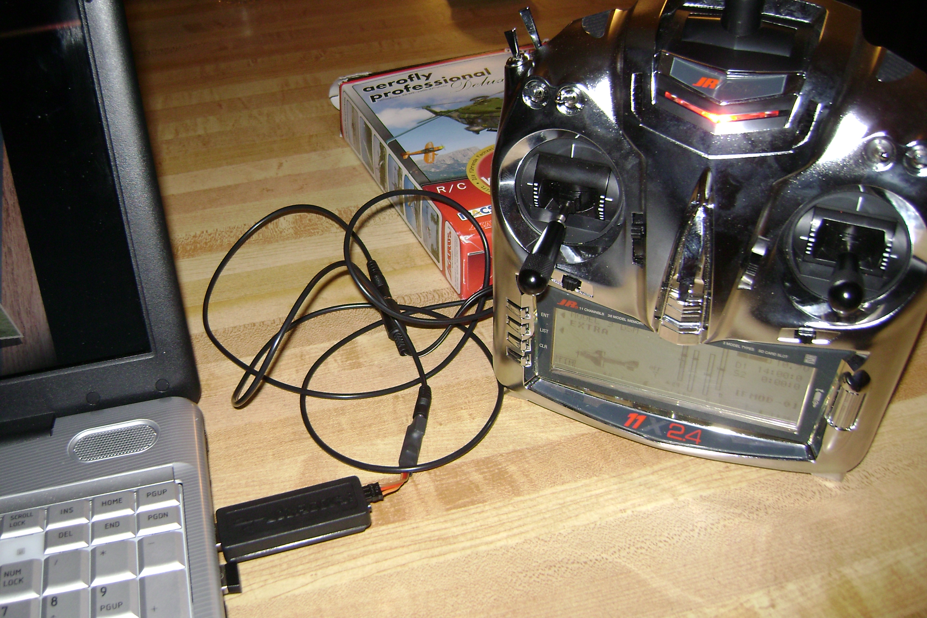

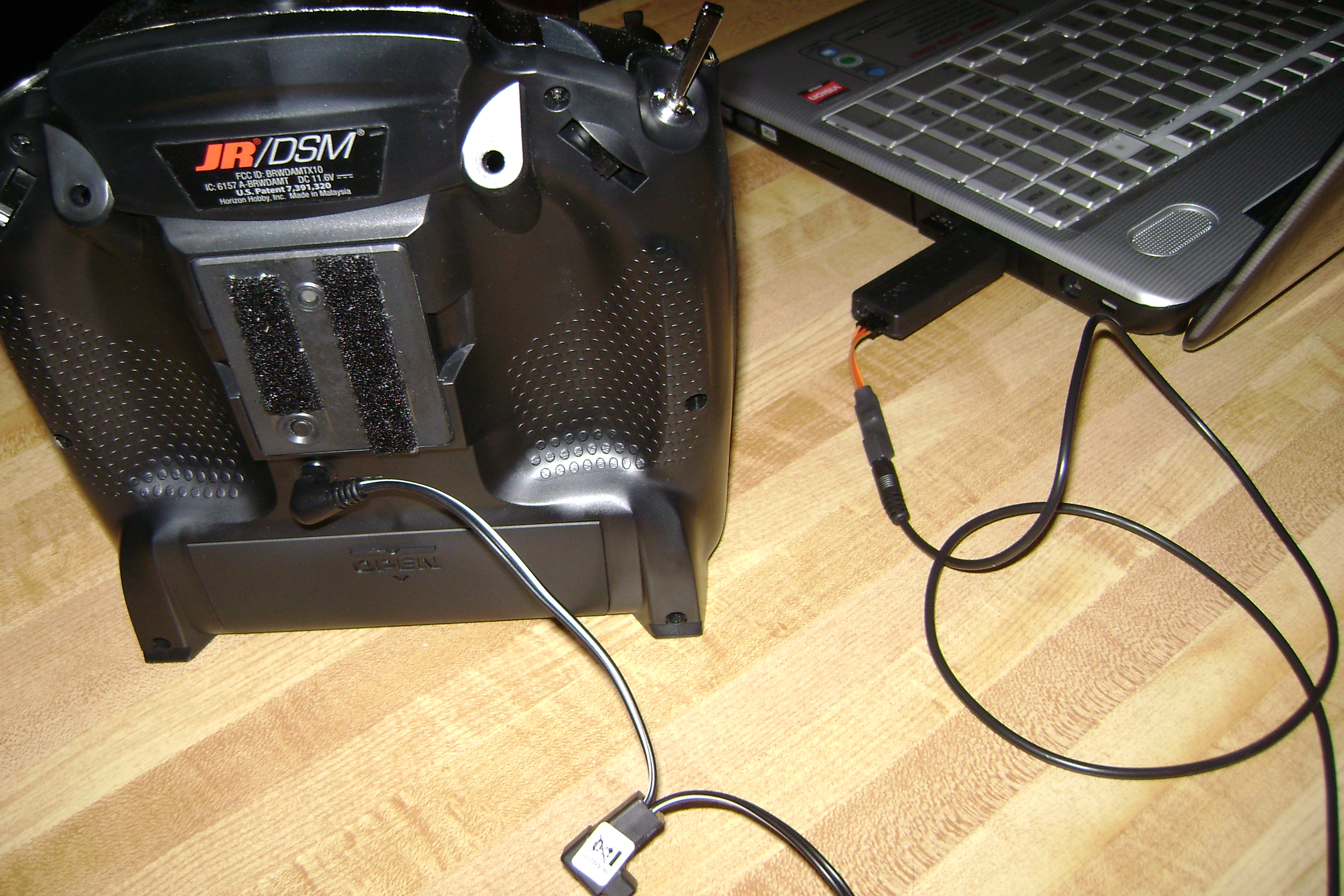

OK finally got them loaded. [img][/img]
ID:	1515095   Click image for larger version
ID:	1515096   Click image for larger version

Did you set your 10x to PPM mode and disable the trainer mode?

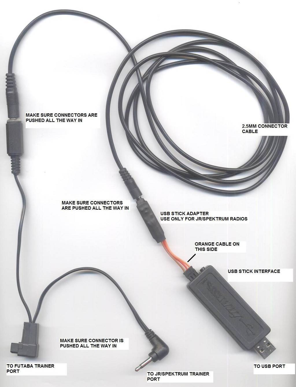

Bullard, do you the cable connections as per the attached diagram?

Yesits connected as the diagram shows. It was working with the 11X, but has stopped and gone the way that the 10X was doing. Since it has never worked properly, even with a Futaba transmitter attached, I am starting to beleive the USB adapter is not working correctly. As soon as I can get together with my friend, we will swap parts to troubleshoot it further. I'll let you know.
