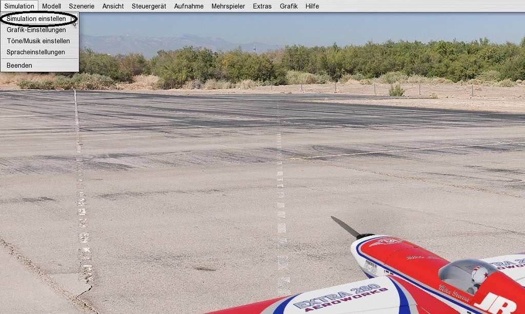

Then move your mouse cursor to the top edge of the AF5 window, you should see the drop down menu. Click on settings as per the photo

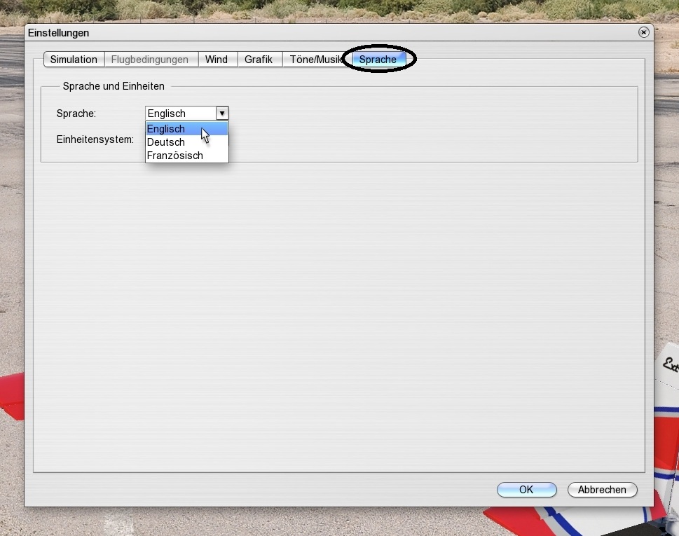

Then in the pop up menu, go to "sprache" and select "Englisch". AF5 will need to be restarted for the language change to take effect.
Then go to Simulation->Graphics settings->Fullscreen

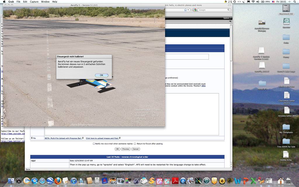

Mike. When I do as you suggest, I get another small window in German. See Screenshot #2 attached.
And the only thing that shows in the menu bar is Aerofly. No Simulation or any other drop down choices.

It's asking you to do a calibration. I think this is normal for startup. Click OK. I'll try to guide you out of this calibration mode step-by-step. Basically, you just need to accept all the defaults first, get out of cal mode, and select the correct language option.

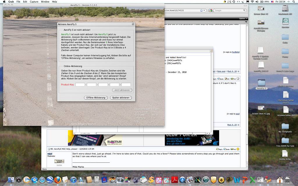

Thanks, Mike. OK. I clicked and got a window that's asking for my Product Key. If I activate the software at this point, I won't be able to return it if I don't like it.
I did briefly see some propeller rotation before the Product Key window opened.

Don't worry about that, just go ahead. I'm here to take care of that. Could you do me a favor? Please take screenshots of every step you go through and post them so that I can see where you're at

It looks like its not activated yet. Key in your product key whcih can be found on the main disk and click the right button to activate through the internet

You're right. It's not activated yet. The manual says don't activate it until you are sure everything is running "flawlessly" because once you activate it, you can't return it.
I'm not sure I'll like it until I see it work. Am I between a rock and a hard place?
what now?
