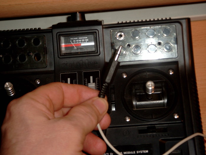

I have aerofly pro and a Robbe/Futaba F14 radio.
It is connected to my pc via a 9 pin serial to a trainer module
on the radio. Downloaded patch, remove crystal, turn on radio,
and it worked fine. Second time was a no go, the cable was not
making a good connection to the radio. (see pic).My questions
are;since I am in Germany, can I get a replacement cable with-
out having to mail everything to the states? And what would I
have to do to upgrade to DELUXE; costs,trade ins etc...?
Thanks in advance

I don´t have access to another radio, but am pretty certain
that the problem lies with the cable connection at the tx.
On the 3rd attempt I wiggled the connection at the tx and
got it to work. further attempts were however, fruitless.
How do I go about upgrading here in Germany?
