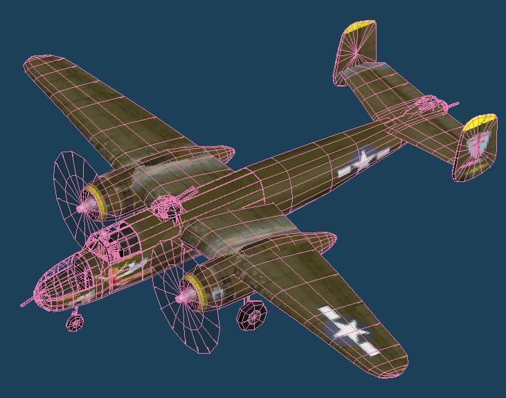

Under Construction!
But it may take a while yet...

hey Rodeo, what program are you using to make your planes?
Old 10-13-2005 | 04:59 PM
Joined: Feb 2004
Posts: 254
From: Tuebingen, GERMANY
Default RE: B-25 Mitchell
Hey Scott,
I'm using Metasequoia LE R2.1. This is a freeware version for 3D construction.
Btw, since you asked in another thread:
Creation of AFPD models consists of 3 steps.
1. We are using a freeware cad program named Metasequoia LE 2.1a
The creator's and download website is:
http://www21.ocn.ne.jp/~mizno/main_e.html
Workshops can be found on:
http://kimagure-hikoki.hp.infoseek.co.jp/index_e.html
http://rcp.web.infoseek.co.jp/Rc_hp2...asequoia_e.htm
http://www.rc-sim.de
2. The 3D files are converted by a free program from Ipacs.
Write an email with name and address to [email protected] to get a personalized version.
3. You have to set up the TMG and TMD files for your model.
Find workshops on:
http://www.rodeo.onlinehome.de
Regards
Rodeo
